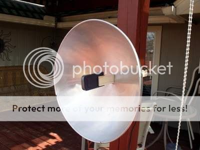

Put a parabolic dish behind it.
A metal bowl, colander, wok, etc will give it directionality and increase its range.
I did this with a wifi receiver and my signal on a distant router went from 1 bar to five.

Beetle may be right about the dish not being so useful at this wavelength, however i thought it worth a try. it is correct that you should only attempt changes on the receiving antenna, so the dish is only necessary for the receiving end.
It was only a suggestion based on improved receive I had experienced on a signal I believe to be about 1/8 mile away from me. My increased bandwidth went from 12 Mbps to 50 Mbps by aiming the dish at the source.

A parabolic dish for 434 MHz would need to be about 4 feet in diameter to really boost gain, and that is with a half-wave antenna at the focal point. A bowl or something similar might act as a primitive reflector, but you would need to experiment with the spacing to get the most out of it. try a small pizza plate about 2.75 inches behind the antenna, and adjsut to see if you get any increase in performance.
