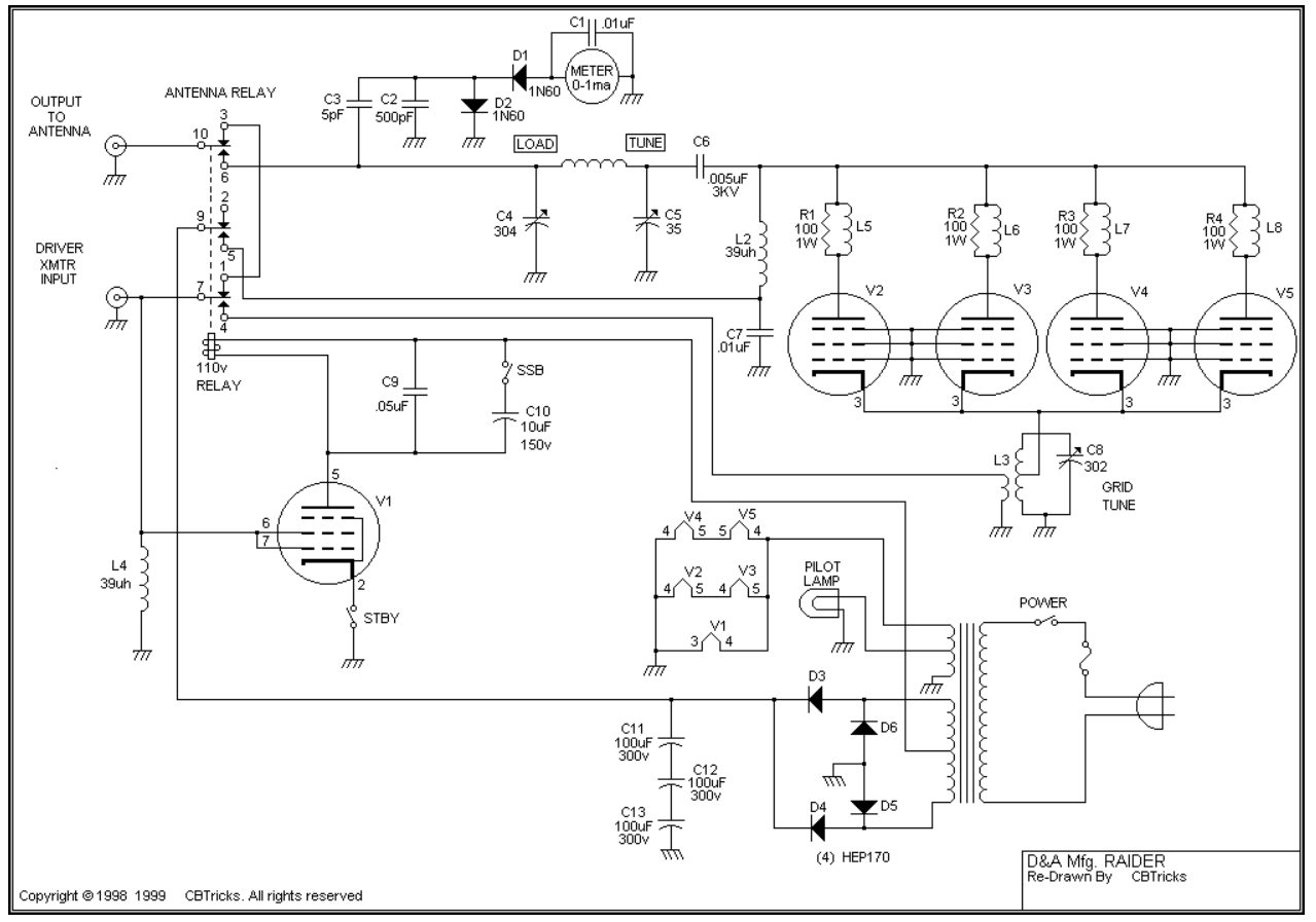

I,m new at posting a thread ! Here goes ...... I have a nice D&A Phantom three stage amp that I,m freshening up ! All is finished but one problem in the keying circuit ! This is the triple stage version ... 4 - 6LQ6,s driving 6- 6MJ6,s with the 6AQ5 tube keying circuit , 2 relay version . I cannot find a schematic anywhere that shows this 6AQ5 tube circuit ! The problem is I did not pay attention to which pin on the 6AQ5 tube socket that the negative side of the 10uf 150v capacitor gets soldered to !!! I believe that I have it narrowed down to Pin 4 (6vac) or pin 5 ( 450vdc ,Plate) ... If I,m correct, this capacitor comes into play with SSB . I have powered this amp up on am only (capacitor not soldered to the tube socket, SSB switch is off) into my Ameritron 1500 dummy load with 4 watts of drive. I have 900+vdc and 450+vdc from the power supply and the amp loaded up 500+ watts with a 4 watt dead key ! Looking like I,m good to go aside knowing where to solder this 10uf 150v cap to the 6AQ5 tube socket !!! Any help would be appreciated , Bruce
The negative goes to pin 5 and the plus through the SSB switch to the hot side of the relay. Here is the Raider:

I thank you very much for your time DrAudio , I thought it might be Pin 5 . Pin 5 has 450vdc on it and the SSB switch has 450vdc on the off side of it, I don,t understand why the capacitor is only rated at 150v ? This capacitor was blown apart when I removed it !!! Your thoughts ? Bruce
It is odd that they only use a 150 volt cap but it's not a component that fails very often on D&A amps. When I replace one I always use a 10uF - 450V just because. Caps are inexpensive so might as well upgrade it when replacing.
Thanks again DrAudio , I will do that 10uf 450v upgrade ...... just because !! Can,t thank you enough for your time , Bruce
That schematic has one difference. It shows the heater wiring for a 12AQ5 tube. The 6AQ5 will generally have the green/yellow striped wire feeding the correct voltage to the tube's heater. The 12.6-Volt green wire-to-green wire voltage from each transformer's heater winding is split half-and-half between pairs of the large tubes. The green/yellow striped wire is the center tap of the 12.6-Volt winding. In the diagram above, that would be the wire feeding the 6.3-Volt pilot lamp.
nomadradio, thank you for commenting in this thread, this amp has the green wire with the yellow stripe on pin 4 of the 6AQ5 @ 6.3vac ..... I have read an older thread of yours discussing the solid green wire (12.6vac) from each of the 3 transformers feeding the 4- driver and the 6- final tubes in groups of 4 (10 tube , 4+4+2) . Pin 5 in @ 12.6v on a pair and out on Pin 4 @ 6.3v with a jumper to another pair in on Pin 5 @ 6.3v and Pin 4 to ground ! I was confused at first as to how 12.6v can go in and 6.3v comes out of the same tube, but the amp works ! I enjoy working on the old tube stuff, been doing it for years and still learning thanks to forums like this and people like you and DrAudio out there waiting to jump in and help someone in need !!!! Thank you , Bruce
