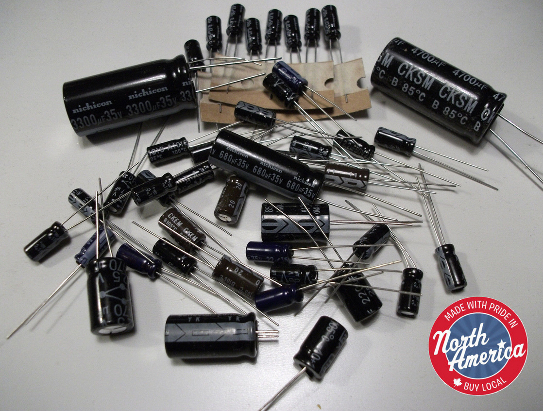

You've already seen my sales pitch on eBay and rejected it, going for the cheaper ones. You are not the first one to make a purchase based on the lowest price. I also would like to thank LC and many others from this site, who over the years have recommended and purchased my kits. Here's what you missed out on;
- Guaranteed quality, fresh parts. No hidden China gems.
- component values that meet or exceed stock. Over the years, technicians/hobbyists have discovered that some values if changed, improve the the operation of the radio. Many of those improvements are incorporated into my kit. No other kit has this. They just read from the service manual and provide whatever is listed. Under rated voltages, documentation errors and all. I eat my own dog food here and install my own kits when working on a radio.
- Additional documentation. Actual color photo's of the radio with component locations shown. Better than any SAM's manual.
- My kit is not the cheapest but I believe is the best bang for your buck. Buying a capacitor kit is similar as buying gas for your car. Not all are the same. Some are better than others if you do your research. BTW, I offer members of this site a $1 discount as well.
https://www.ebay.com/itm/142035580095
