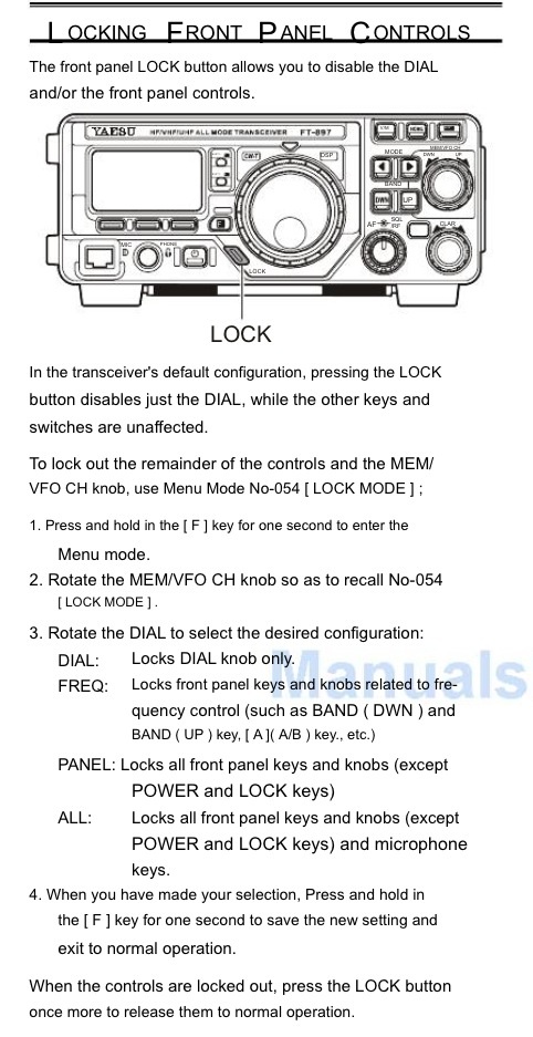

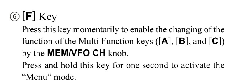

I have a Yaesu 897.
Yesterday, I turned my desk lamp off before turning off my radio. When I reached with my finger to hold the power button down to power the radio down, I accidentally held down the function "f" key.
I then held the power button down to turn the radio off. I didn't think anything of it and then today when I turned to radio on, there is a funny symbol on the bottom right of the screen at the end of my S meter and the VFO knob will not work.
The other small knob will let me turn through the frequencies but the large VFO knob won't function. Other than that, the radio seems to be working fine.
Does anybody know what I need to do to get the VFO knob functioning again? It seems like I may have accidentally activated or deactivated something...
