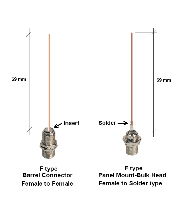

Something like this no ground plane ect.
No. The link I sent shows four radials, each one attached to one of the four corners of the SO-239. Gotta have the radials; this is a 1/4 wave ground plane, bare bones. But put it up 10 feet in the air and it'll beat the snot out of the rubber duck that came with the HT. 20 feet up, even better. Just don't forget to use GOOD feedline if you're going to go much above 20 feet or so on 70 cm.
If you're going to have to use it indoors, might as well use the duck.
