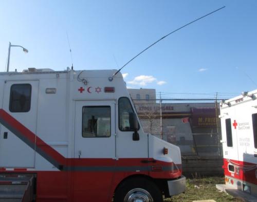

You see, when you've organizations like the New York King County ARES and the Red Cross that are using your products on NVIS (40M to 80M) for EMCOMM on their emergency vehicles, then it's probably because the antenna is doing what it's designed to do!
NVIS on ARC command bus with the CHA V1

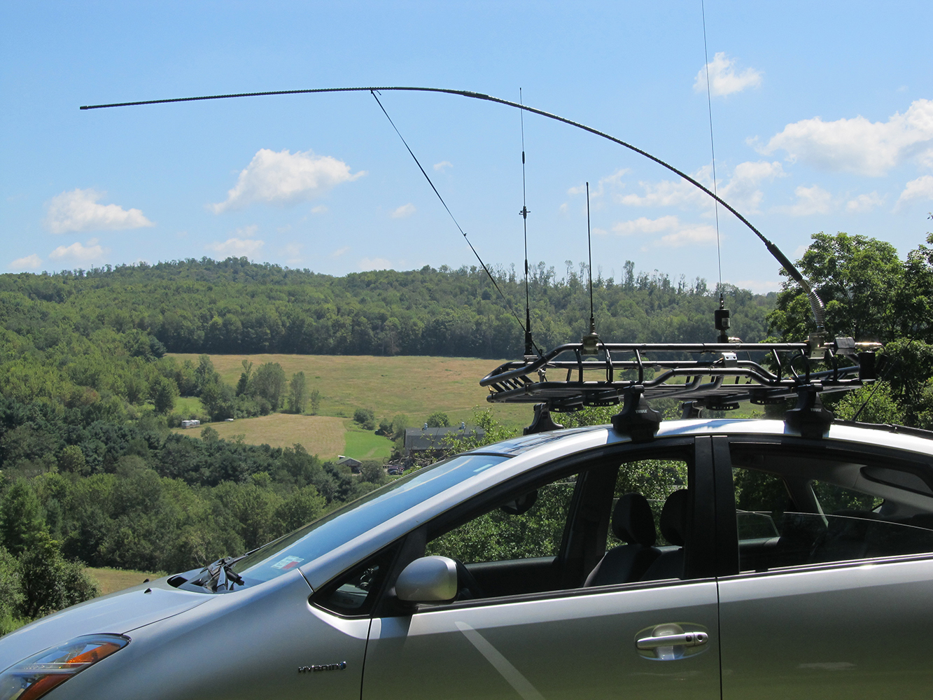

The same Emergency Coordinator (KC2NBE) operating his personal vehicle and with the CHA V1 antenna installed on a NVIS (40M - 80M) COMM on a Toyota Prius. This model is probably 5 to 6 years old.

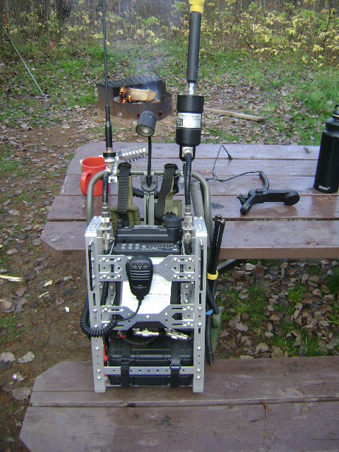

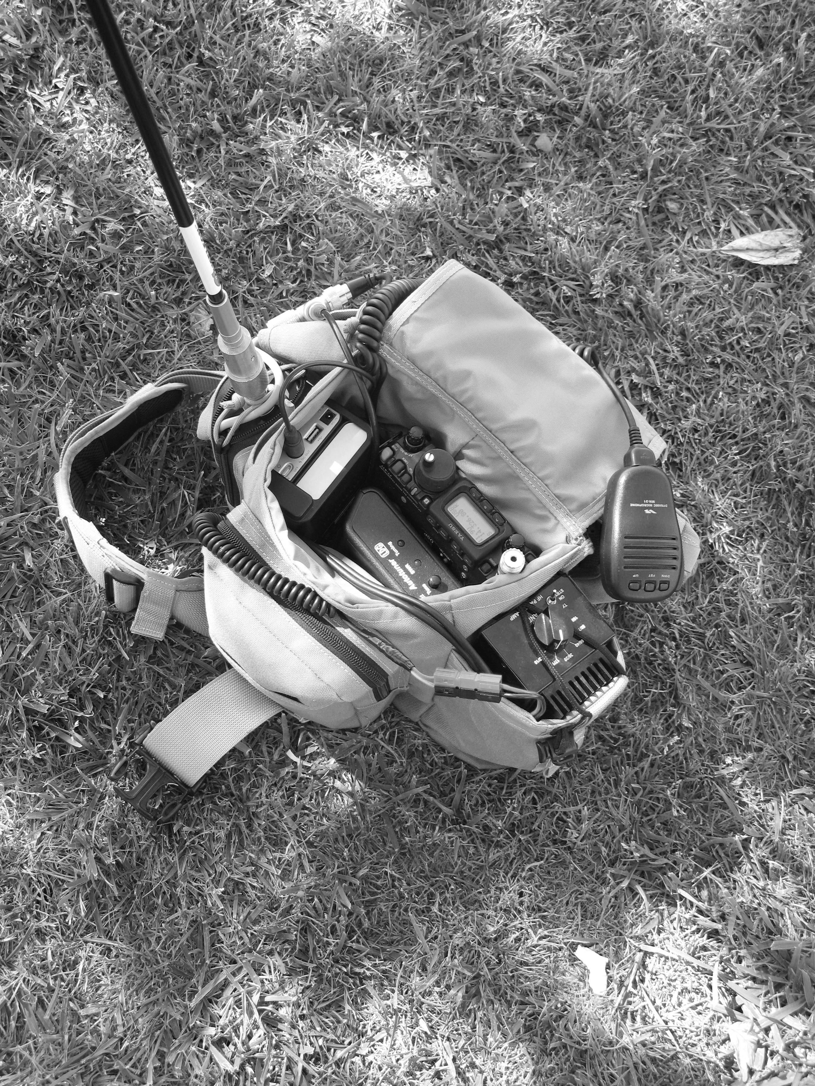

The above system can also be used to make manpack systems like the ones below.

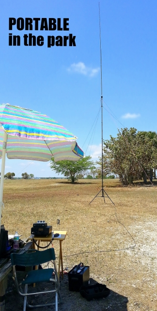

The same system can be used portable at the park.
