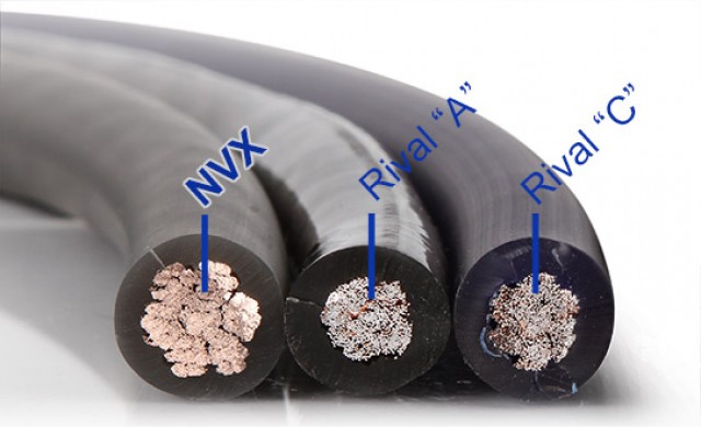

The gauge of the black wire might be too small. Generally. If U use 1 gauge red. Black
"Return"
is a larger diameter like O gauge.

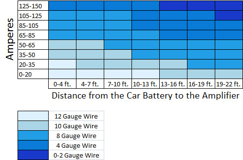

When installing an aftermarket car audio system, having the correct wire connections is very important. The right cables and wires ensure that the strongest signal is going to the correct destination, and that a sufficient amount of power is being sent to the receiving components. One of the most important connections in a car audio system is the power and ground cable that connect the vehicles battery to an aftermarket amplifier. The gauge of these cables will determine how much power can be sent to an amplifier.
As a general recommendation, Sonic Electronix follows the guidelines below as a quick reference in determining the appropriate wire gauge.
Wire Gauge Size Total Amplifier RMS Wattage
0/1 AWG 1000+ Watts
2 AWG 1000-1500 Watts
4 AWG 400-1000 Watts
6 AWG 600-800 Watts
8 AWG 200-400 Watts
10 AWG 100-200 Watts
For a more detailed formula in determining the gauge size needed for an installation, please refer to the steps below. By following these guidelines, you can factor in the distance you are running the cable. This is a more accurate way in finding out what gauge of wire you need and can possibly save you money in the long run of your installation.
1. Find the total RMS power of each amplifier:
* Monoblock Amplifier: The RMS power of the single channel will be the wattage you will reference. For example, if you have 500 watts RMS on one channel that is your final result.
* Multi-Channel Amplifier: Take the RMS power (in watts) of one channel, and multiply it by the total number of channels that amplifier has. For example, a 4-channel amplifier has 40 watts RMS on each channel, so 40 Watts x 4-Channels = 160 Watts RMS.
2. Find the total RMS power of the audio system: Add the total RMS values for each amplifier in the system to reach a grand total. If you only have one amplifier, then the value you found in step one is all you need.
3. Multiply that grand total by 2
4. Divide that number by 13.8
The final number is the approximate current draw of the car audio system. Find that number in the “Amperes” column on the chart below. After determining the distance from the car battery to the amplifier, you will find the appropriate gauge for your car audio system.
Link to web page this information is from.
http://knowledge.sonicelectronix.co...lifiers/what-gauge-wire-do-i-need-for-my-amp/

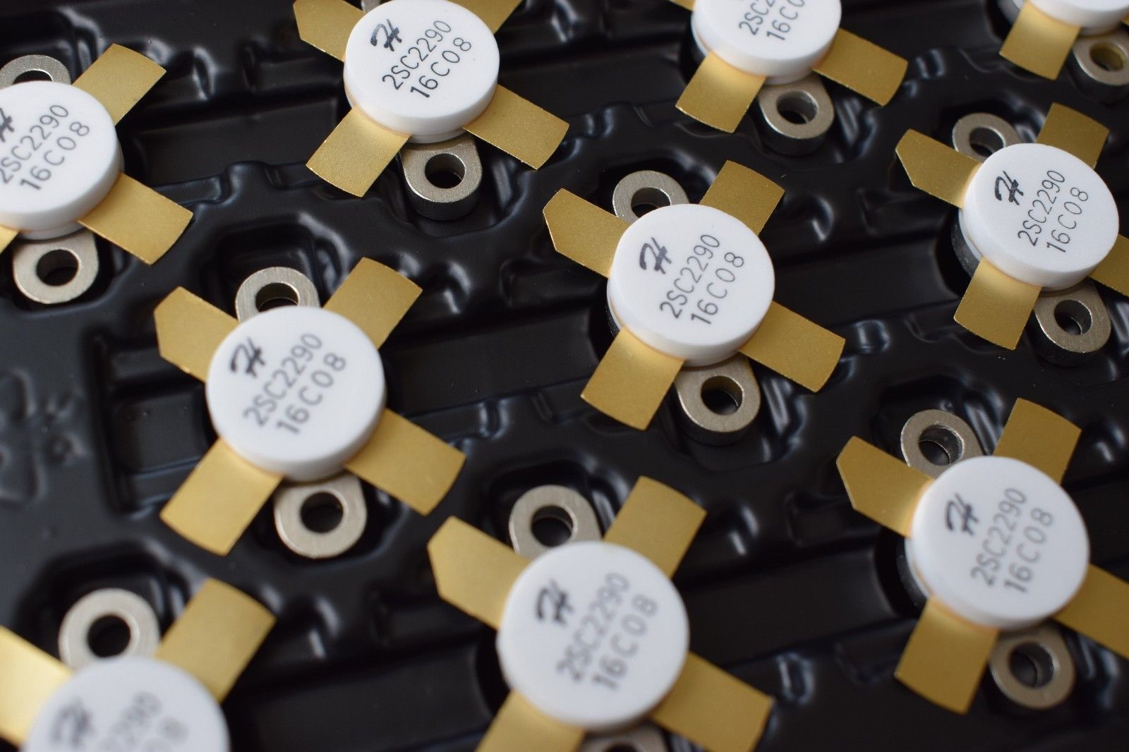

What a great deal, sounds like your all set. What you might consider some time in the next 6 months is getting a replacement set of 2290 finals just in case. They are getting hard to find and the price will only skyrocket. You can find them at the below link.
https://www.rfparts.com/2sc2290mp.html

As with everything, it's all opinion and price. For me, if possible, I want to keep things stock. I would like to improve the bias in the ts250 but my knowledge prevents me from doing it myself (for now). There are no real techs I'm aware of (nearby) that can do the work.
90% of the reading I have done on the replacement transistors has warned me away. I do not overdrive and refuse to over volt so they may be fine for me but If I spend that kind of money, I'd rather save for better equipment when I get my ticket. You obviously have more knowledge in rf equipment than I do and I don't yet have the disdain for rfparts that you do. I do believe you would agree with me when I say that the old Toshibas are better quality than the offered replacements.
HG 2SC2290
Hmmm. Never forgiven RF parts for buying up all the stocks of M-2057.
Then skyrocketing the price to the stratosphere. They did this with 8950 also.
I buy NADA from them.
https://www.ebay.com/itm/HG-HuaGao-...349719&hash=item25c146ba43:g:yPAAAOSwZVlXoK7ZView attachment 22226
My understanding is HG finals are no better then the DEI finals. Hey it sucks that the prices of Toshiba finals is up there but it's all supply and demand. Same thing holds true for older tubes, it is what it is. I have my stash of Texas Star amplifiers and parts, hope to keep them going for 15 years or longer. Who knows who I will even be talking to then, not many young people are getting into radio these days.
