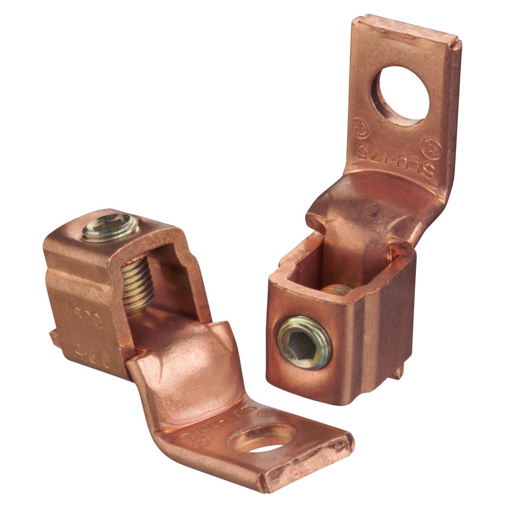

U can avoid hassles & save a lot of time by using these copper wire connectors.
Though for AC. They come in several sizes & work great in audio or Rf linear amp.
installations. Hmdepot-menards etc. Cheap at HD.
Have a similar connector purchased in Bulk for up to 1 gauge. For O I use the very
large copper Blackburn. I have the machine to bang out the ends. But.
Time is money. They come in quite handy. Fast no issue installation.

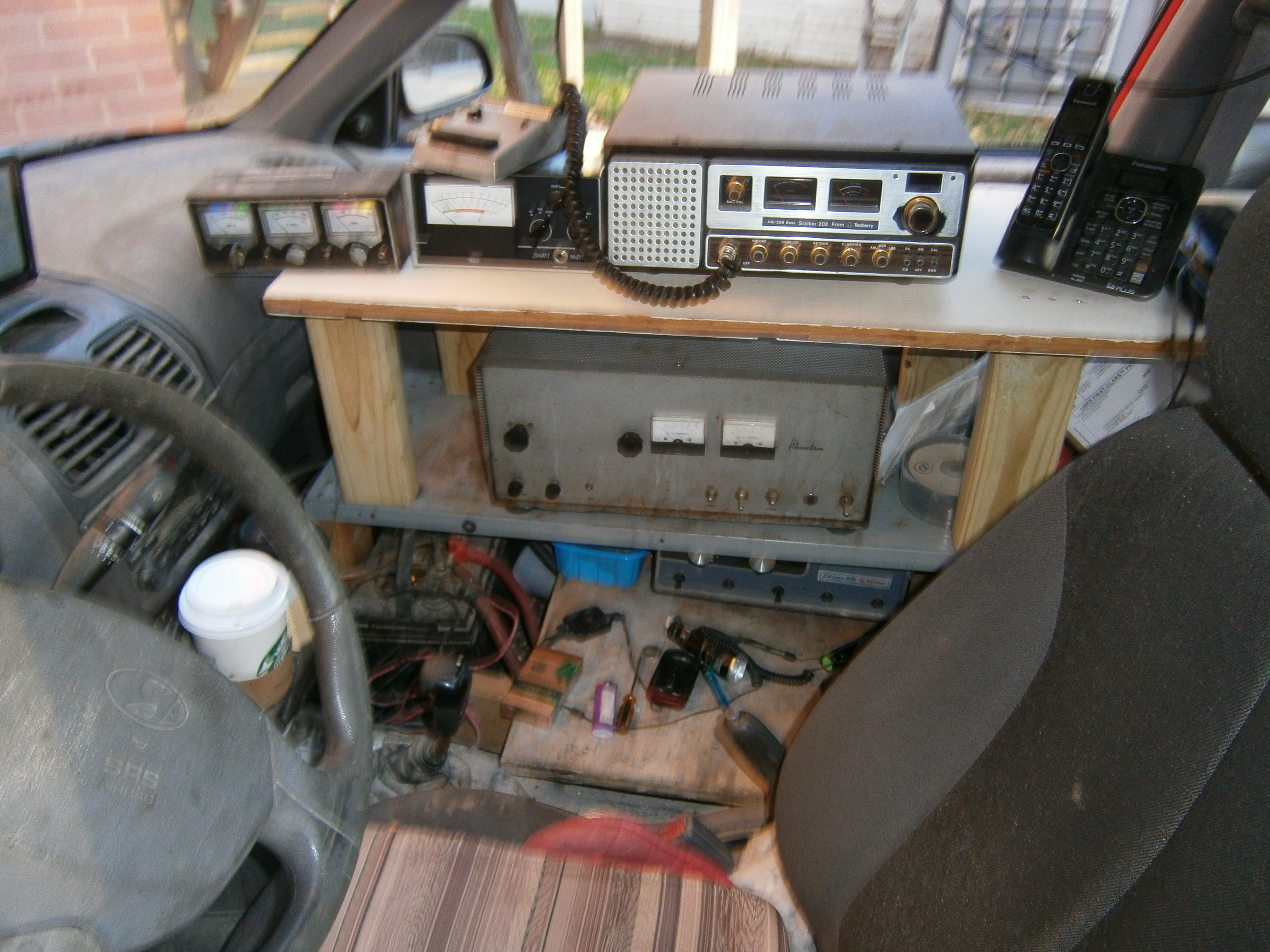

Reactions: Old_Crow

My second car cannot have a CB.....smiles. Not because of "computer issues".
But #1 because it has a usable passenger seat ! #2 Usable rear seat not crammed
with 7 x 110 pound batteries !!!!!!!!!!!!!!!!!!!!!!!!!!!!!!!
