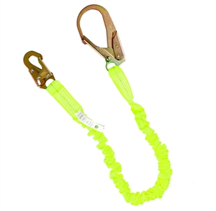

the next thing you need is a lanyard to connect yourself to the tower.
all the rules above still apply.
something like this:
