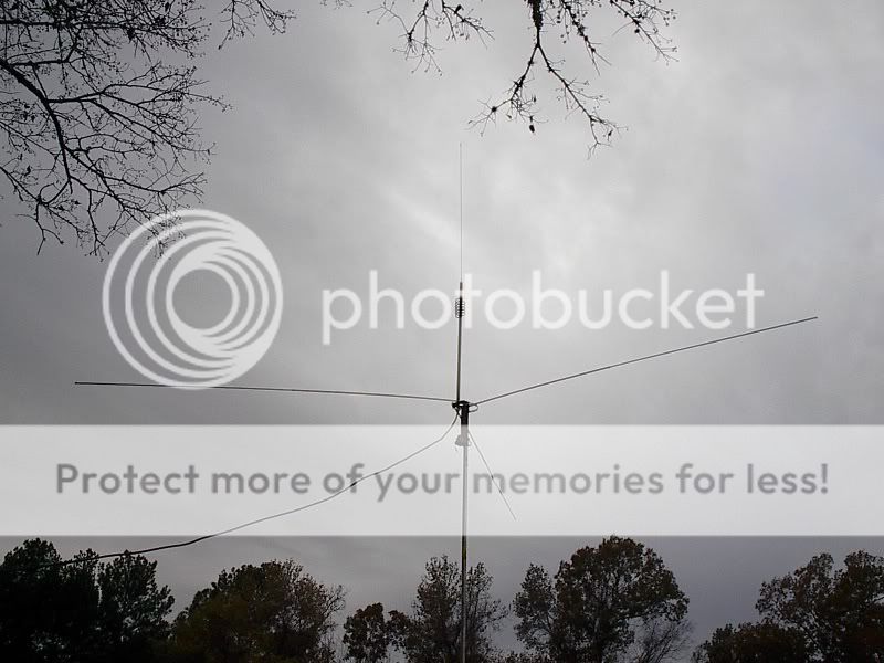

Key blanket, Kale and Booty Monster were just relating a story of what Kale has done with some antennas he made. Where is the money issue you are so bent out of shape about?
I have thought about how one of these coil type antennas would react with an effective ground plane up about 30' high also. I wonder if a well-designed coil would help control the reactance and allow us to feed at the base with a 50 ohm match? Is it possible to find 50 ohms of resistance at resonance in a ¼ wave whip without changing the nature of the antenna?
I can get close, but I find it a bit difficult to do with a 1/4 wave SS whip even with small extensions trying to add reactance and still reach resonance at 50 ohms impedance. I believe the reason is because the 50 ohms point of resistance in a resonant 1/4 element is not quite at the open end bottom where we typically feed it, and when we add inductive reactance to overcome the capacitance that a 102" whip shows, the 50 ohm tap point moves and we have no control over that placement unless we change the nature of the whip to some form of matching device in series with the element. So my question was, how do guys ever reach the magic flat match everyone talks about with a 1/4 wave whip?
I find in a 1/4 wave whip tuned to resonance in 11 meters, that about the best resistance you will find at the base is in the area of 35 ohms and if you do anything more to reach pure resistive and move the resistance up towards 50 ohms you are just adding loss to do so. If this is so, then maybe a coil, if effective, can do what it takes to overcome this result. If not, then maybe it is better to live with a bit of reactance and try for 50 ohms of resistance for our match. For me, such results must lower the radiation resistance in the radiator a bit and that probably is not a positive. So, we have to find another way of affecting reactance in the whip and still keep a 50 ohm tap point at the base. Could it be that a coil in series with the radiator can do this? Maybe Kale can tell us if that is what he finds with his technical approach to antennas. And if so, does this then make up for some of the shortcomings for a shortened radiator.
Blanket, if I were going to do the project being discussed here, I too would do it differently. But, I would like to hear some more about results and factors affecting those results, rather than your pathetic words about what you think personally about Kale, his antennas, his idea, and how much money it cost.

That "base" antenna is a waste of money. Four 75 dollar antennas to make a 1/4 wave ground plane? 300$ for that?

I had a spare 27" shaft that I mad a base antenna out of a couple years ago. I had a ground plane from an old clr2 and used the ground radials from an old starduster I had. It worked really well believe it or not. I kinda slapped it together pretty quick.
Some facts.
Coils are lossy, doesn't matter what they are, how they are made. Just a fact that's not possible to get around. If you have a choice, not using a coil is 'better' than using one. Because of a lot of reasons, that "choice" isn't always up to the end user.
There are two steps in 'matching' any antenna. The least amount of reactance is desirable. That means adding some 'opposite' reactance to neutralize what's already there is an option. The other thing is matching whatever the antenna's 'resistance' is to the feed line and transmitter. That can means raising or lowering the antenna's apparent resistance. All of the above done with the least amount of loss possible. That 'loss' thingy is usually the product of 'how' you get there, how the matching is done. While there can certainly be some fairly 'large' losses, in general, they don't amount to a lot so they are 'acceptable'.
An antenna's length determines resonance to a very large extent. That length is a combination of physical length and electrical length. If either or a combination of both are at lest 'close', then the thing is probably gonna be resonant. The 'other side' of that characteristic is that antenna length also determines it's radiation pattern. "Full sized" antennas will radiate a 'better', or more classic pattern for that type antenna than a 'shortened' version will. The difference between the two is determined by how much the short one was shortened. Shortys typically have less range than the long ones. Another fact of life, doesn't matter if you/I believe it or not. "Momma-Nature" says it's that way, you argue with her if you want, I'm 'chicken'!

Marconi, money would be the last thing I would ever think about when I put this antenna together. Money has nothing to do with this topic. I didn't post the picture. The antenna works better for me than the 6 element quad I had before. For all of you that have critisized, run down and have made statements that says it is a failure are not laughing at me. You are laughing at the one that designed it and that has been trying for 3 years to get me to build it. I'm happier with it than I was with the 6 element quad I had before. Put your ass in the real world before you condem anything. I truly BEG all of you that had a part in this to email me at cowtown10k@msn.com and I will give you the phone# of the one that designed it so you can tell him why it won't work. Kale
