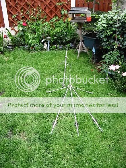

That "base" antenna is a waste of money. Four 75 dollar antennas to make a 1/4 wave ground plane? 300$ for that?

Marconi, money would be the last thing I would ever think about when I put this antenna together. Money has nothing to do with this topic. I didn't post the picture. The antenna works better for me than the 6 element quad I had before. For all of you that have critisized, run down and have made statements that says it is a failure are not laughing at me. You are laughing at the one that designed it and that has been trying for 3 years to get me to build it. I'm happier with it than I was with the 6 element quad I had before. Put your ass in the real world before you condem anything. I truly BEG all of you that had a part in this to email me at cowtown10k@msn.com and I will give you the phone# of the one that designed it so you can tell him why it won't work. Kale
Kale sorry we dont need to tell him anything, many have done real world and to say your loaded coil antenna works better than a 6 element quad makes me think you think we are all stupid. A quad is one of the best if not the best beam anyone can build and your mobile antenna coil out performs it? LOL Please stop while your ahead you are looking very desperate.
I didn't say it works better than a 6 element quad. I said it works better for ME than the six element quad I had. A Signal Engineer Lightning 6. Like I said, I got tired of repairing it from wind damage. I guess now you're going to tell me it wasn't put together right. I'm not desperate at all. I have people all around me that have asked for one but I'm not even close to going into production for them. I'm backed up for weeks on orders for the 10K mobile antenna all time. I'm saying for the last time. I DID NOT POST THE PICTURE OF THIS ANTENNA AND WOULD EVERYONE QUIT USING IT TO MAKE IT LOOK LIKE I'M USING IT FOR A SELL FACTOR. I'm not desperate for sales on anything. Every once in a while I will almost get caught up on orders for the 10K and It takes a lot of pressure off me. Kale

You're right about the radiating characteristics of the coil antenna. The only part that should radiate on a well designed coil antenna is the top 1/3 of the coil on up. This gives it a "bow tie" effect radiation pattern which helps keep more of the signal on the ground. Kale
kyle did not post the pic....i did . i saw the post on his forum page and requested the pic . it did not cross my mind at all as to why he wouldnt just post the pic himself even though it was clear in his post that the antenna is a proto type . now i see why . i did kyle a injustice and that was oposite my intention . and,to be frank,i feel a lil ashamed . i dont have a problem being a "duck" compared to most of you folks and i understand im still a newbie and have a lot to learn and that i dont know jack crap compared to a lot of folks . im sure kyle can appreciate constructive criticizem but some post had no construction to them ,just idiot throat cutting comments . i mean common......heres a guy that if it wernt for him there would be no "10k world" and no 10k for people to brag about or appreciate .
if yall want to crap on someone , crap on me for posting a pic of a prototype antenna .
dont crap on kyle for doing R&D trying to make better antennas for all of us to use at home and on the mobile .

thanks to my buddy dave heres the starduster m800 i owned twice in over 25 years, the lower portion of the legs are missing in this pic
sweet ,I knew you can do it :)
so whats the ring for SWR?
Say what? Bow Tie and keeping the signal on the ground?
