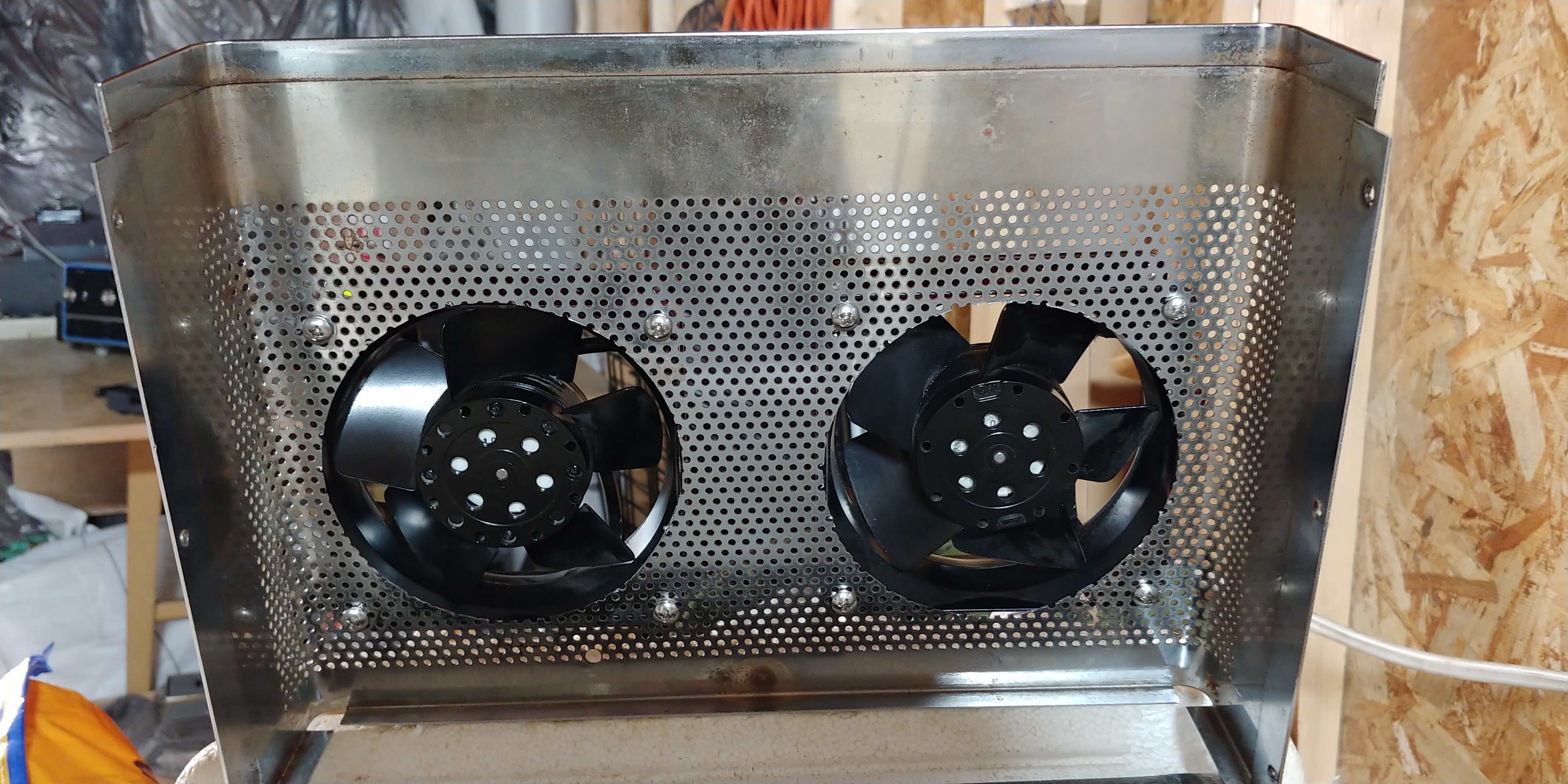

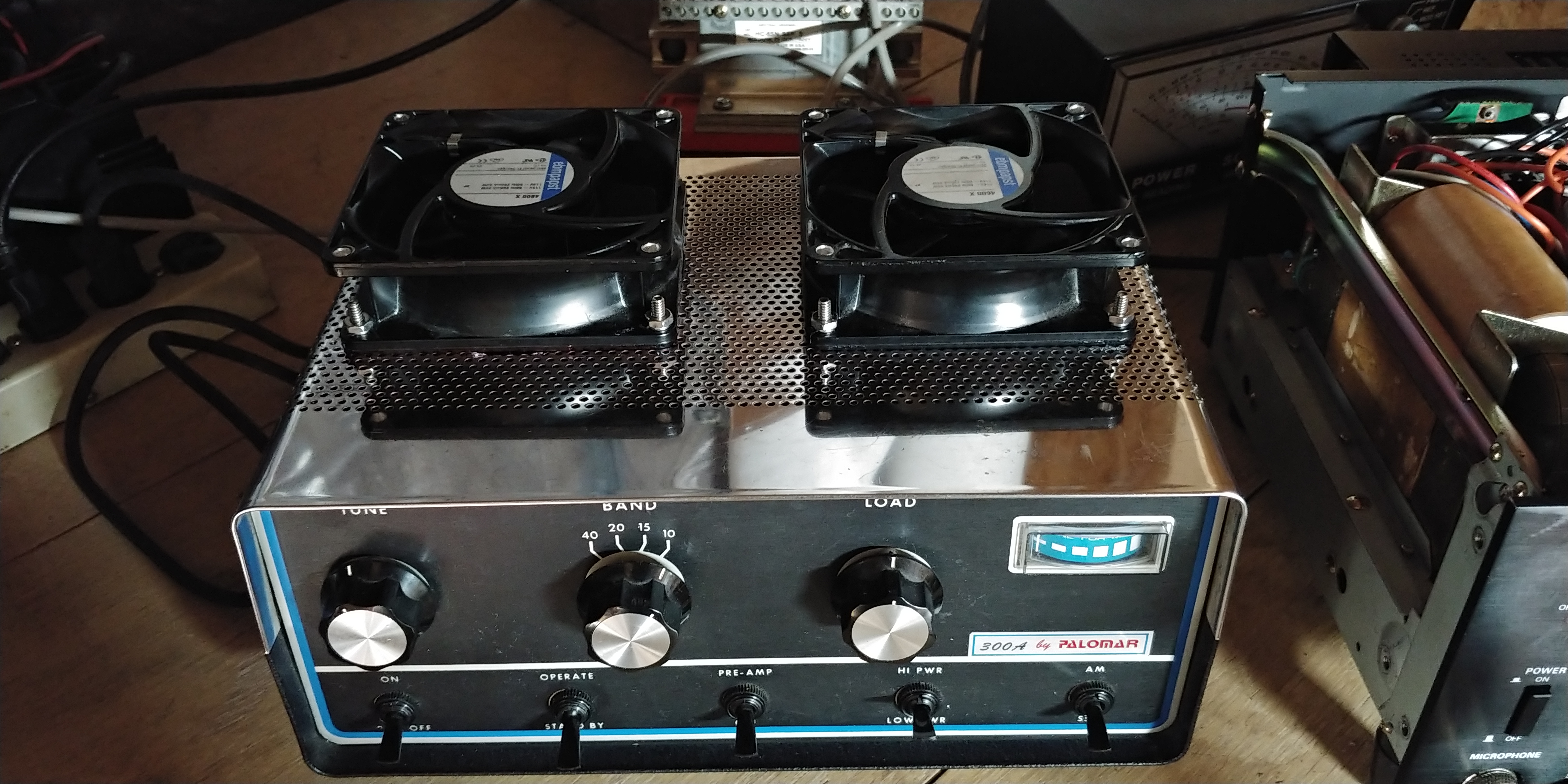

I put a pair of Papst 4600x fans on my 300a and I can talk a long time and it never gets warm. The chrome lid came from a parts 300a that had been poorly peened for taller tubes so I didnt mind cutting the holes for the fans. I still have the pristine original lid.
