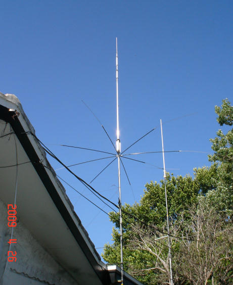

Here is my station it is a mid range setup there are many better around the state.
