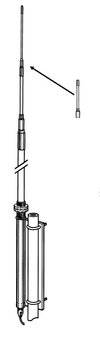

I will presume 1 each male and female 3/8-24 end. Somewhat similar to the Amazon product ASIN B007QXLG0M without the female adapter.
Interesting. I have not seen the new / short IMAX 2000, but I am curious to know if the top section has a pre-drilled and tapped ferrule that will accept the 12-inch extension. I would think there is not enough material to attach a ferrule on the top stinger. Has anyone seen the 12-inch extension?

Yes it would make sense for them to do that, no idea why they haven’t made it available. I was sent one of the extensions from the factory to test and they work as expected.
Big Khuna, where was the added new section for the new shortened Imax installed?
Can you give us a picture and/or show us how long it is?
Marconi
Reactions: AudioShockwav
Here is what Copper Electronics describes for the Imax Optimizer
  • NEW! Upgraded replacement for IMAX-2000 antenna
  • MaxOptimizer allows you to choose between a balanced 10 -11 meter antenna that will perform well in both bands or optimize the antenna for the 11 meter band.
  • To Optimize for 11 meter performance assemble the antenna with the 12” optimizer section installed between the mid and top section as a 4 piece antenna.
  • For balanced 10-11 meter performance leave out the 12” optimizer section and assemble as 3 piece antenna.

Eddie, thanks for that post, I take it from that it goes below the hidden cap inside the antenna if I understand this.
Jeff
There are two capacitors in the Imax 2K. One in the matching section at the base and the other is in the middle section near the middle of section 2.
When the New optimizer is used to maximize 11 meters this new device is connected at the top of the middle section...as I read from Copper Electronics noted above.
Hopefully the Big Kahuna can confirm this.
