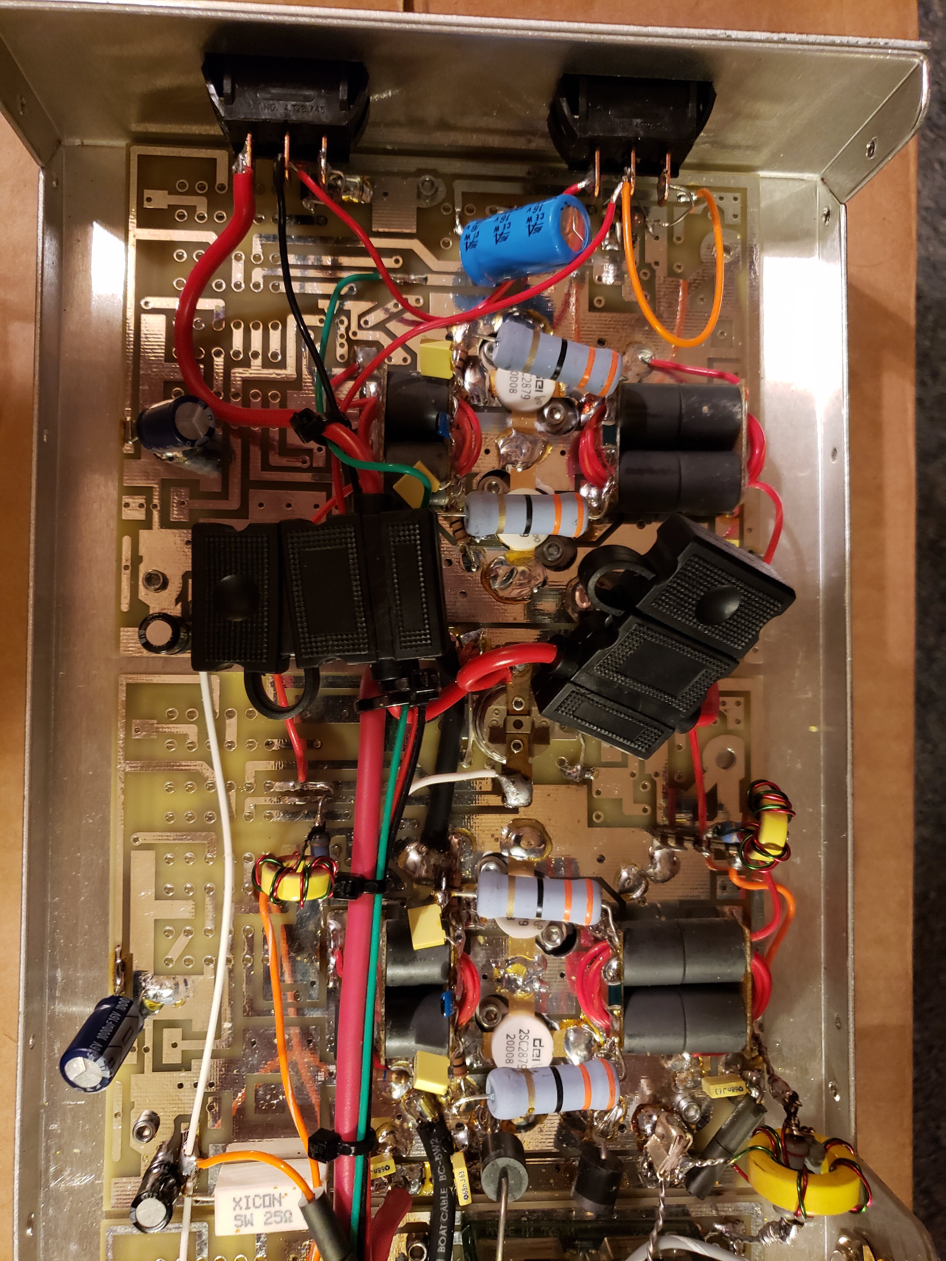

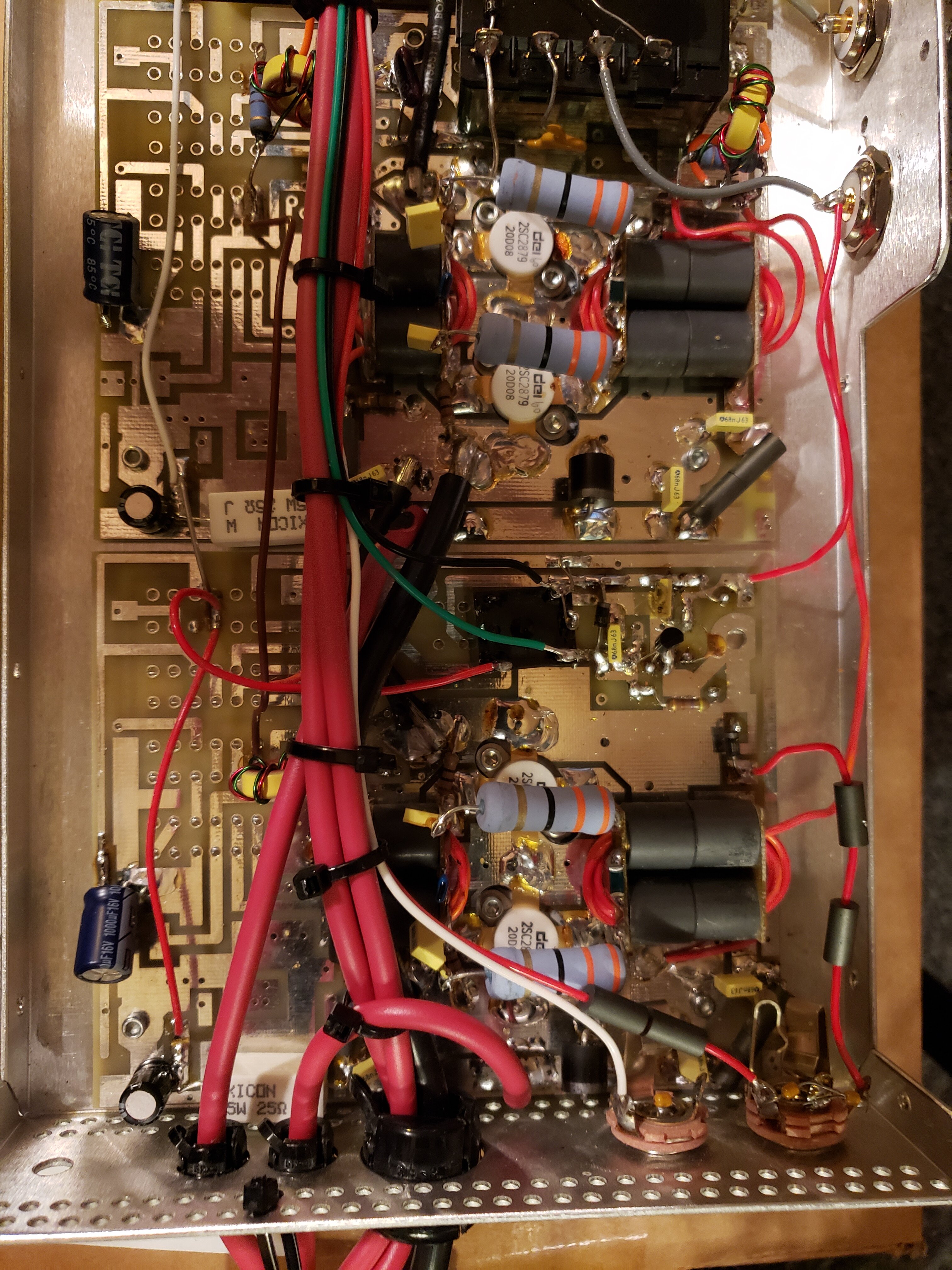

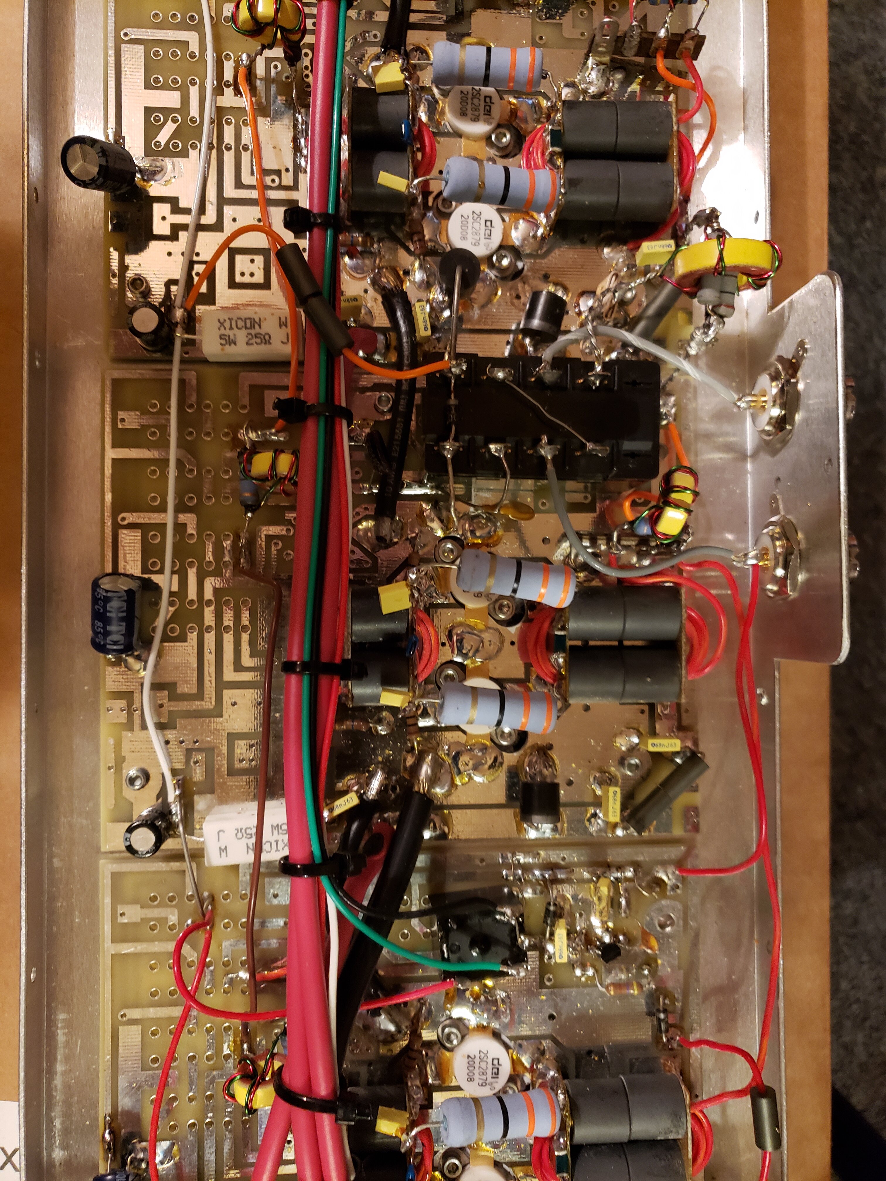

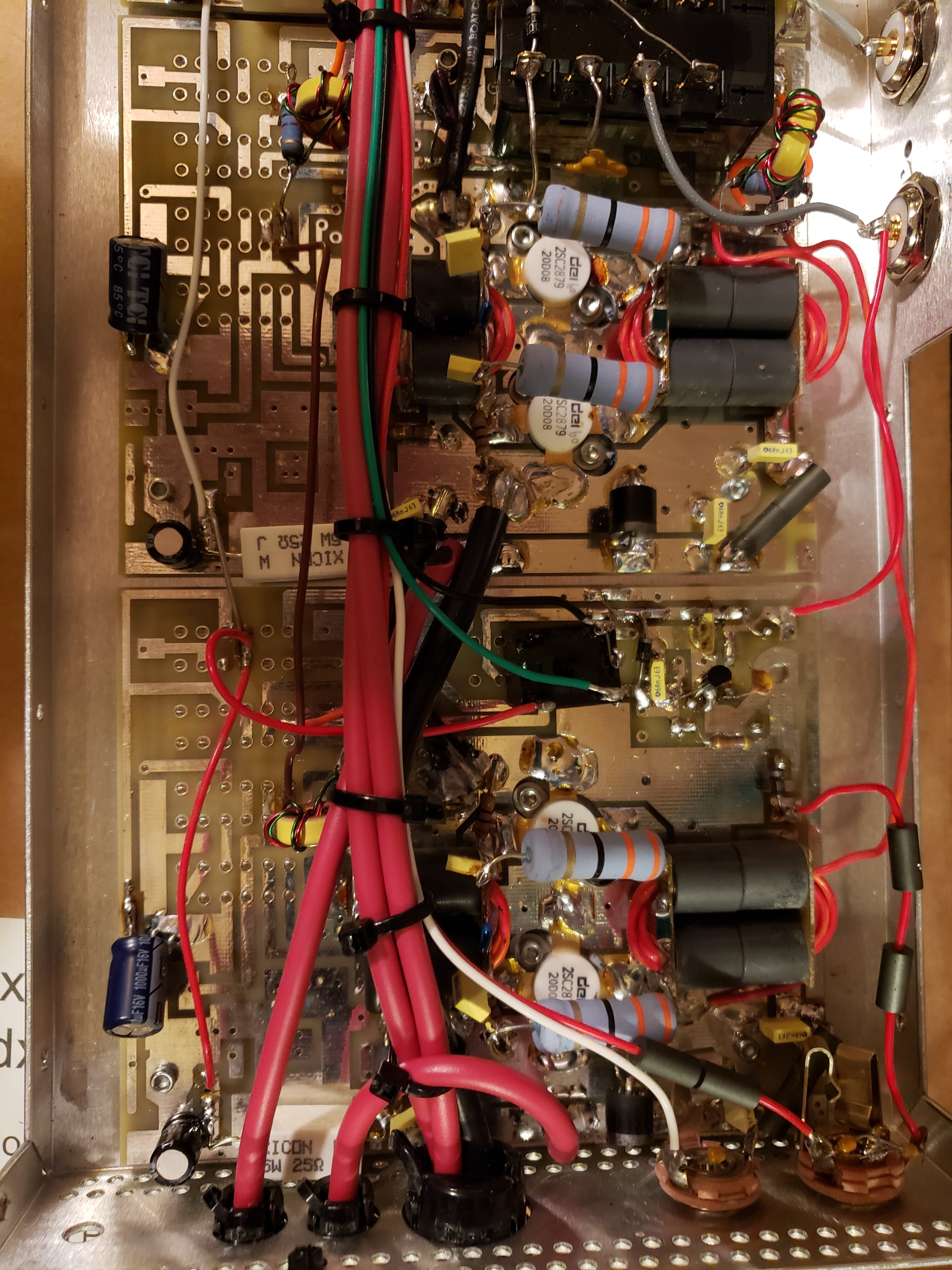

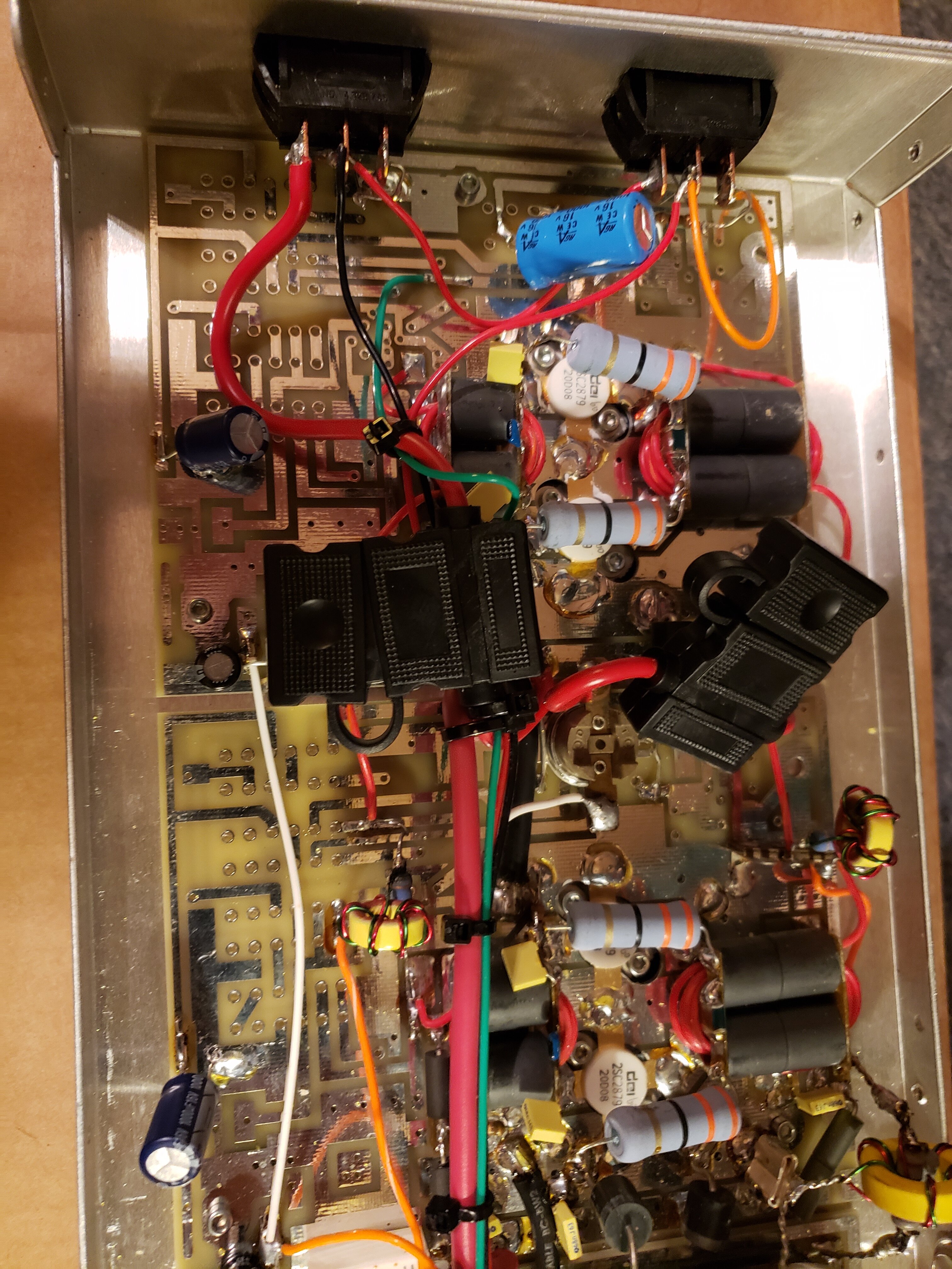

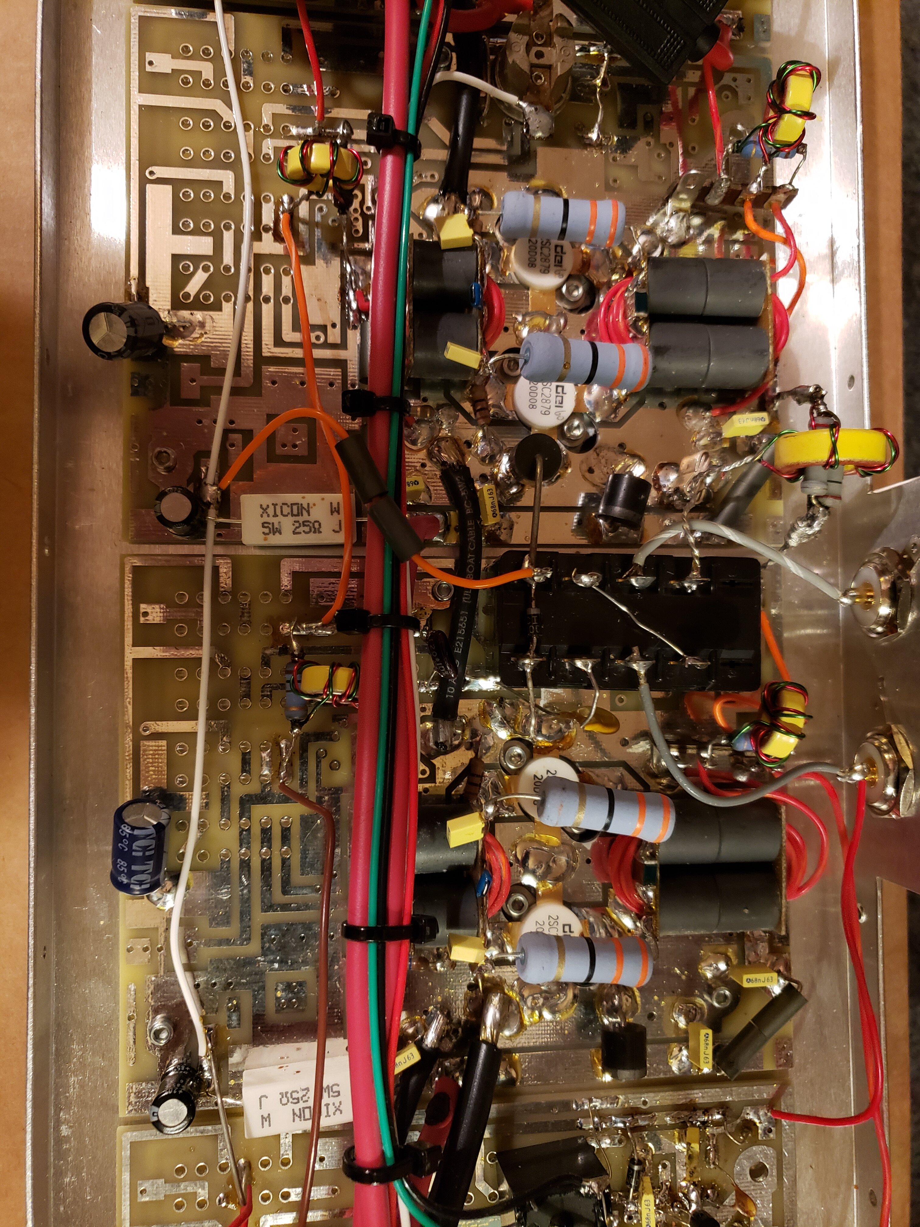

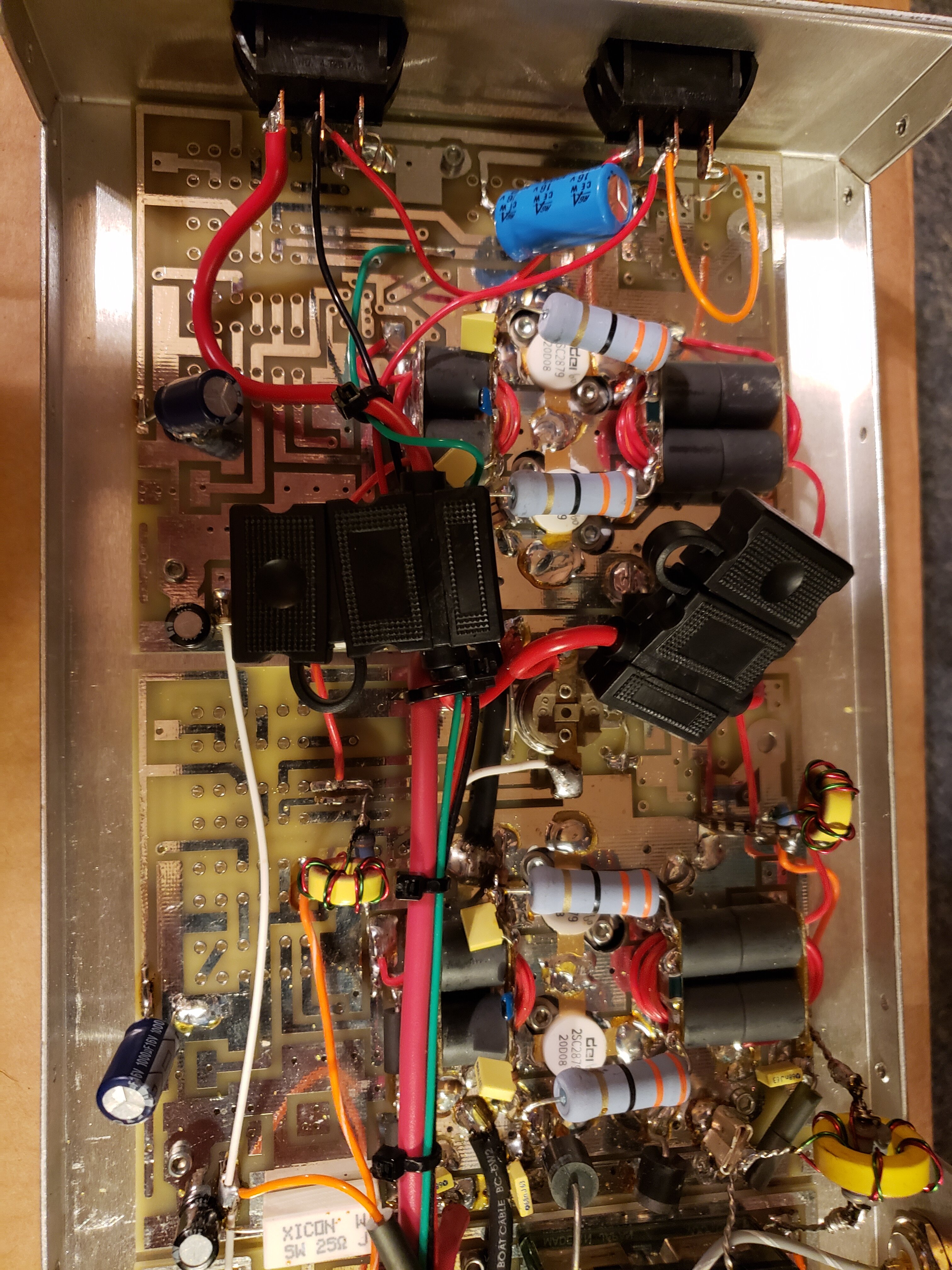

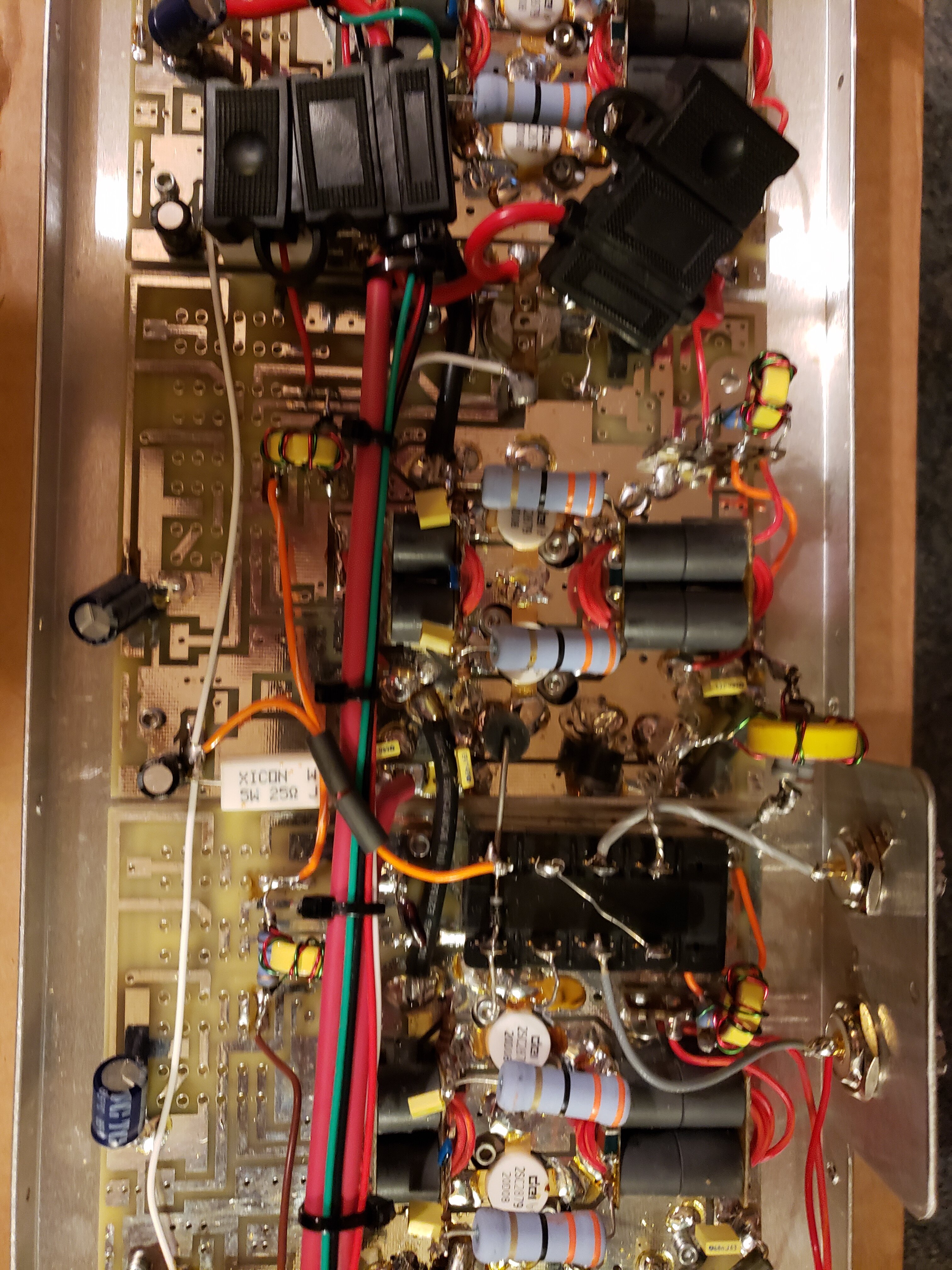

Take the cover off and show us some pictures, maybe someone can spot something wrong or out of place. Maybe a combiner with a bad connection, or output tune capacitor problem.
