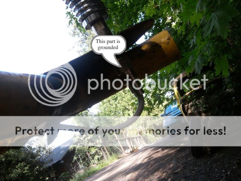

For my antenna, i have the antenna insulated, and the threaded part of the coax cable is grounded.

Pics of my base as requested.
Sorry for the lack of light in this pic
