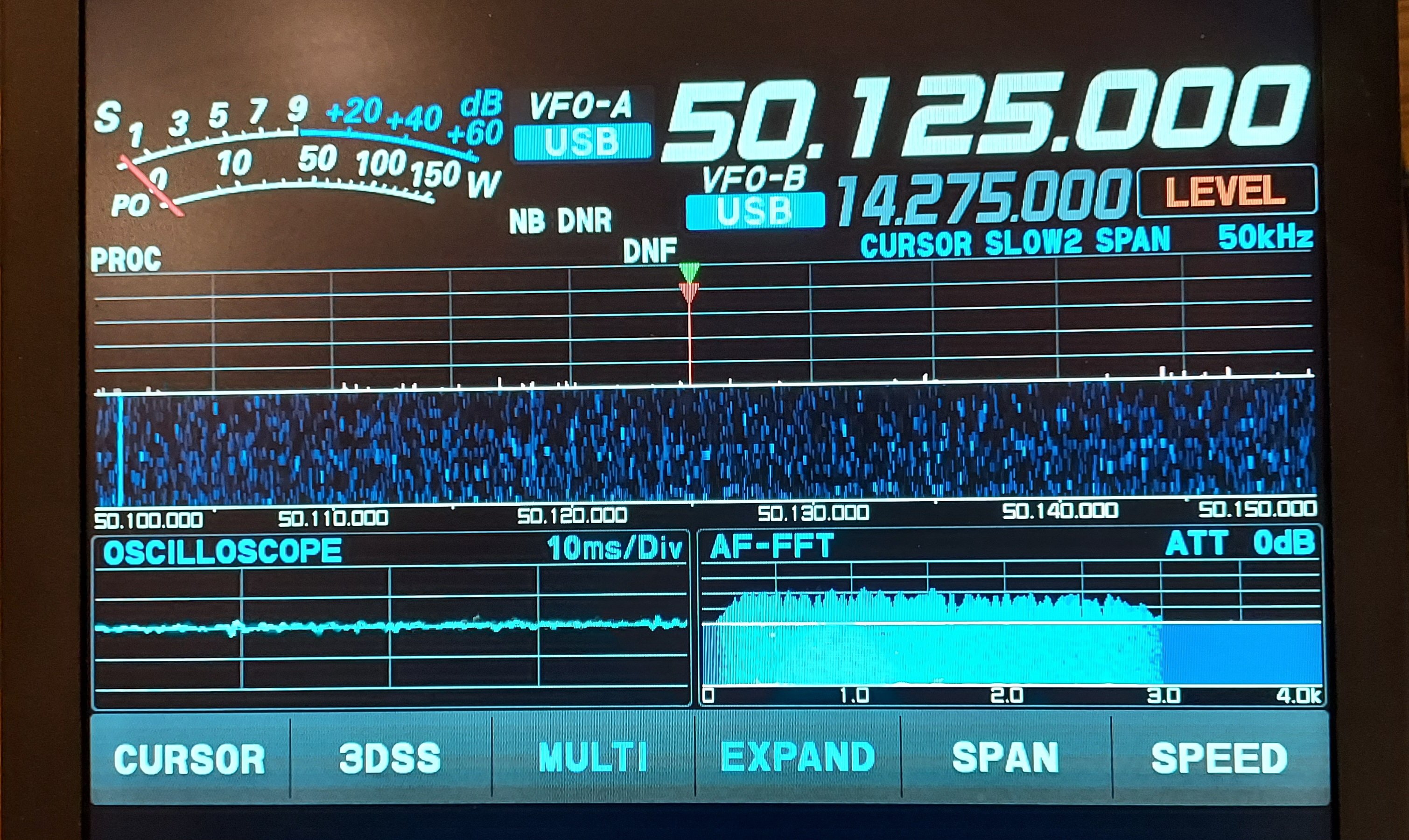

I've been using one for a couple years+ now and have no issues. On it nearly every day during jammed band openings, contests, you name it. No issues. Working DX on 6 bands, no issues. Just a great, low-noise rig with no issues. Did I mention no issues?
