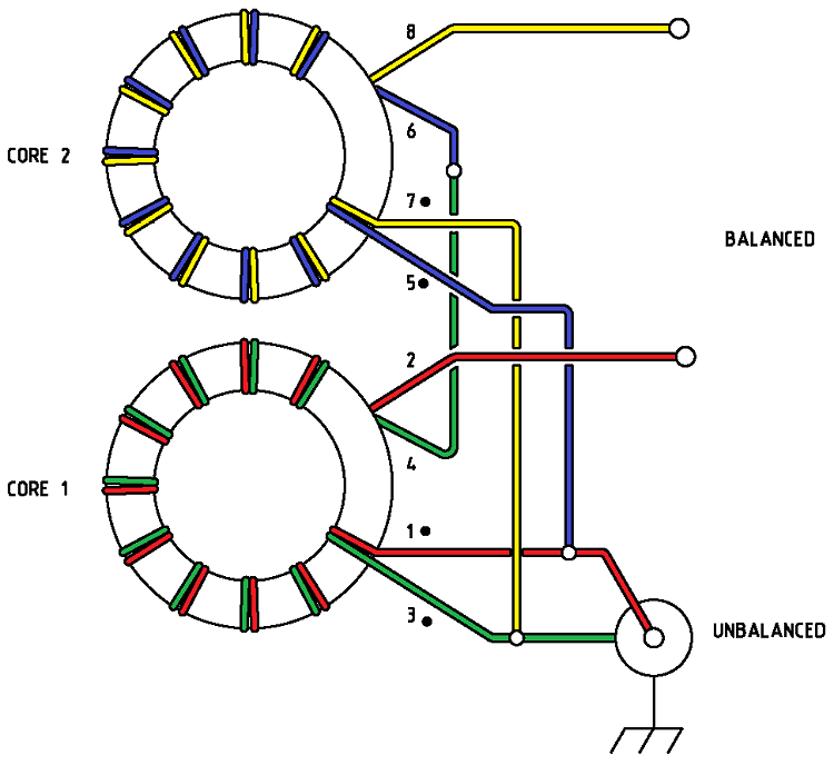

4:1 , 27% 65' up .approx 126' total length.
https://kitsandparts.com/
I didn't screw around. I got the 2 1/4"
#11 AWG (CTL) PTFE TFE - SPAGHETTI from MSC direct.
#12 or #14ga wire. I have a bit of current to deal with so #12
