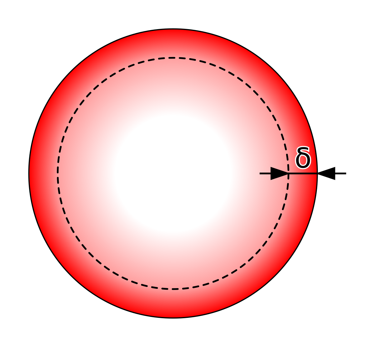

If you do some more research, look for "skin effect" when it comes to RF.
Start here...
