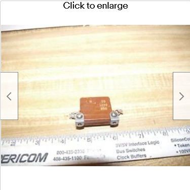

I need to choose between a modern ceramic cap or an old, molded mica transmitting cap for the input to a Hombrew tetrode amp. Both are .05uF although the ceramic is 1kv while the old mica is 1.2kv. Protecting the Exciter is the purpose and I presume 'bigger is better' is the rule I should follow. Is that correct ?
I'm also following W8JI's grid-driven tetrode formula to determine Rg and Rs which at 50W each, takes up a lot of space in the blower box. I can fit the old cap no problem but are there any other reasons to favor one cap over the other? HF only.

If this were a cathode-driven setup I'd recommend the mica. Has more metal in it, and should tolerate the higher RF current it would see.
A grid-drive amplifier should work okay with either type.

Mica all the way! The use of ceramic caps unless we are talking a doorknob is normally about cost. You would see CB amps loaded with ceramics because they are cheap! That is even more true today.
Voltage tolerance surge tolerance, rf resistance and heat resistances favors mica. Few of us can afford to always use the best possible components though and now we have the supply chain issues as well!
