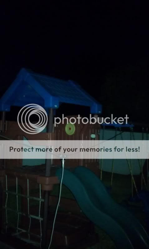

Not exactly proper,(couldn't get the ends tight enough to not sag), but this worked for me in a pinch:
Picture that with your head cocked to the side, and you get the idea of how it should hang vertically!
