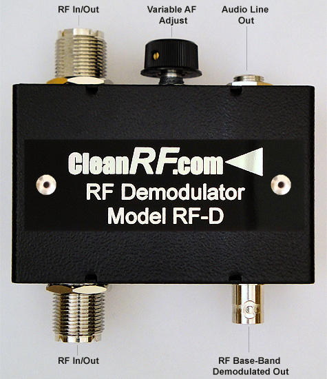

Okay - I'm not sure I follow.
Here a picture of what I did. I'm getting a good waveform on AM and SSB and on one radio I could see some clipping but the clipping didn't go away till the mod was like at 50%. When I was at 100% I could see the clipping but everyone said my audio was loud and clear and not overdriven?
