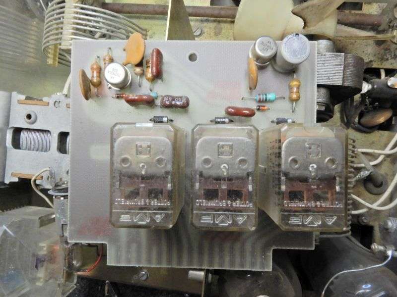

Some early Palomar 300A base linears had all 3 relays and the receive preamp on a plug-in circuit board.
Just one problem. When the relays go bad, you find that particular part hasn't been made in decades. The pins have a non-standard pattern. All the relays this size you can buy have a pin pattern that won't line up with the holes in the pc board.
Oops.

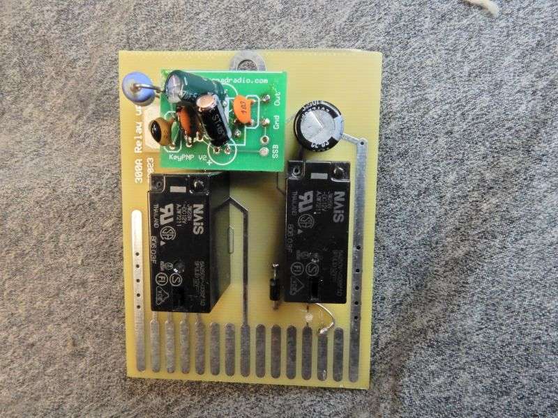

Haywiring a relay you can buy with wires that go into the circuit board holes is clumsy and time-consuming. First prototype of an outright replacement for the whole board was expedient, using a keying circuit board we make in quantity and sell on fleabay. Looks a bit clumsy, but it worked once I patched an error in the layout
Only takes two relays if you leave out the receiver preamp. Just don't need the grief I'll get from folks who try to use a preamp and don't like how it makes the noise level higher.

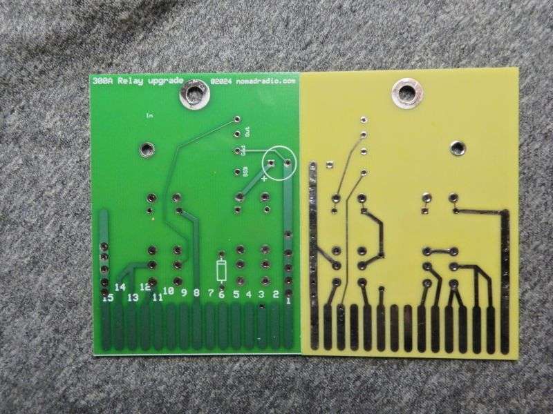

This project has had ups and downs. Getting the CAD software to remove the green solder-mask paint didn't exactly work the way it was meant to. The foil-trace "fingers" are supposed to be exposed metal, not covered in the green stuff.

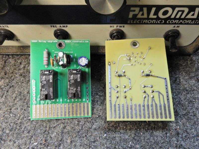

Decided to move the keying circuit onto this board, rather than the piggy-back arrangement with the separate keying circuit board.
Got the partial exposed copper on the front side. The solder side is still totally exposed, but that's not really a problem.
I'd call this a production board, but some parts in the keying circuit are kinda crowded. Plenty of room, just didn't spread them out fully.
Not sure I want to revise it any further. Sale of the prototype boards hasn't exactly set the world on fire. Could be I just waited 20 years too long to come up with it?
