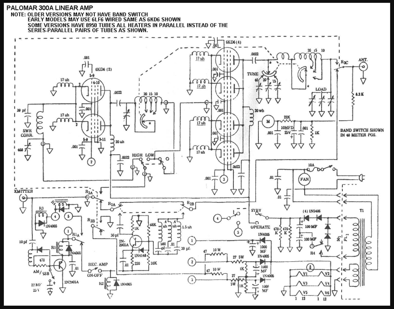

does anybody knows if the Palomar 300A base amp, relay shatters when been us in SSB mode, is there and adjustment to hold it a tad longer while talking and not sound like morse code

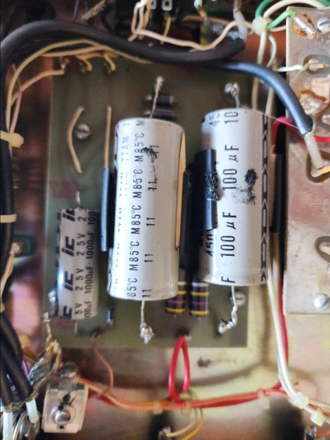

It looks to be a 22MF cap there now, bottom left corner. you can check the value and if it's bad, replace it or move up a couple.But I'm just guessing here.

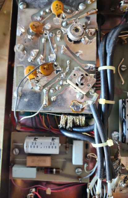

well, today i got a chance to look at the bottom of amp no 22uf i believe the 1000uf is the correct place for ssb ???

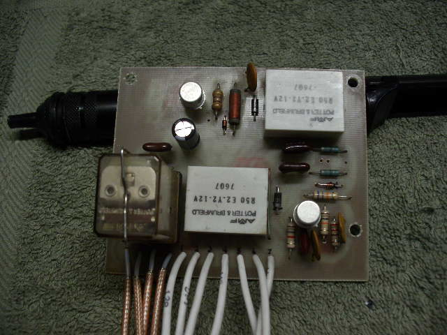

the SSB cap is on a small board with 3 relays on it seen from the top with top cover off. Here's 2 examples.
well, mine has a 47uf i tried the 470 relay hangs too long on am the good thing was i found 2 loose ground straps one did not have enough solder and was just dangling 2nd one was missing a screw, and put the 47uf back in.it is what it is 108 feels like in FL today thanks for the info anyway was worth the effort
