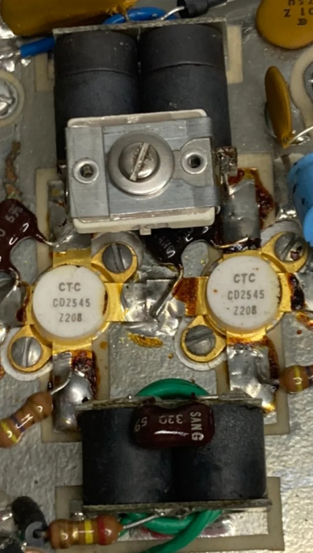

There is one of these available now, not sure how to identify the transistors though.......
