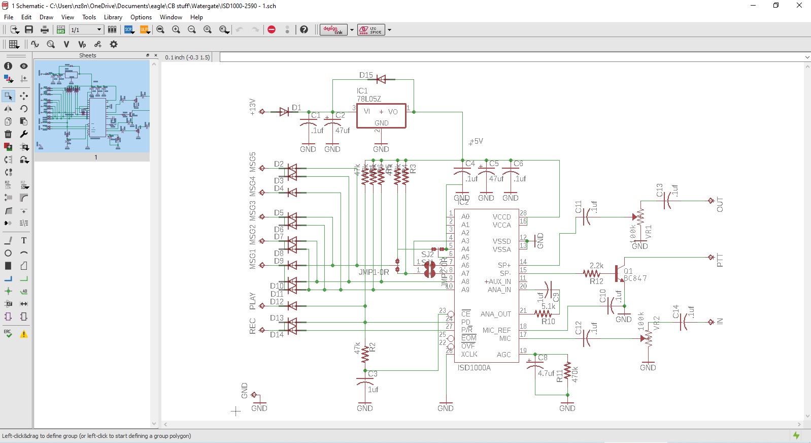

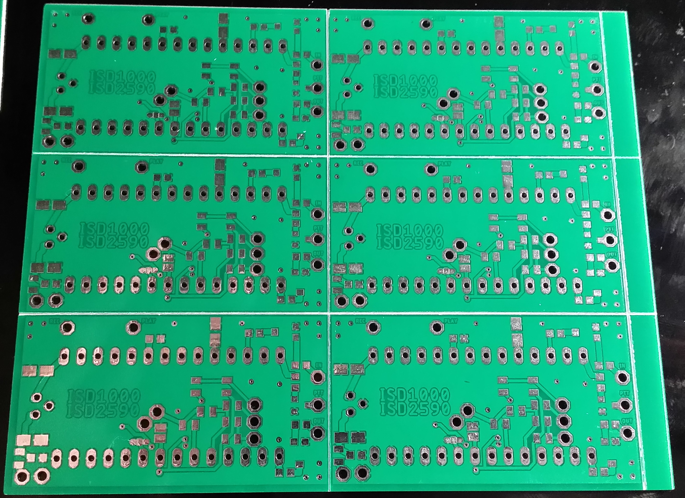

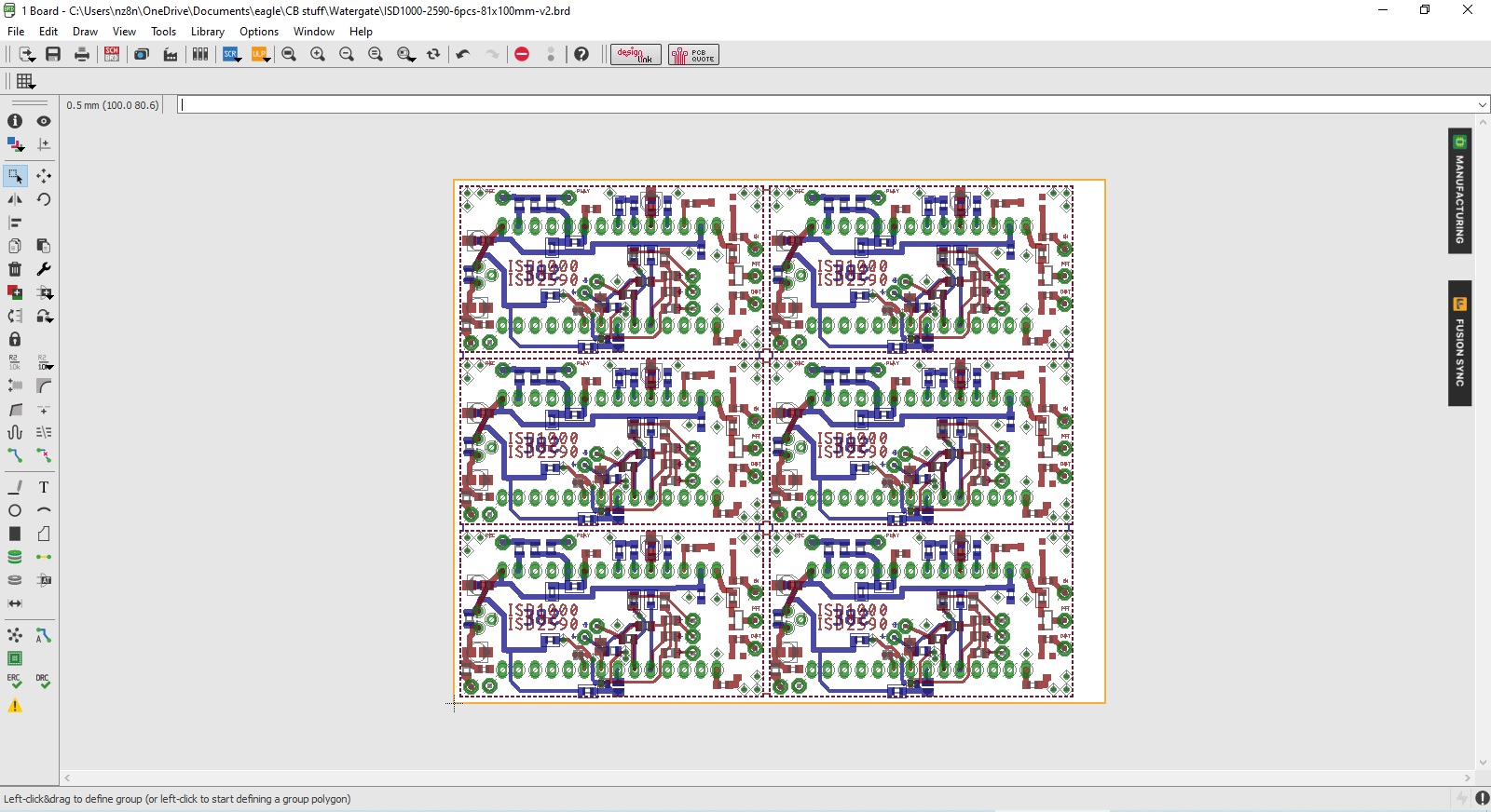

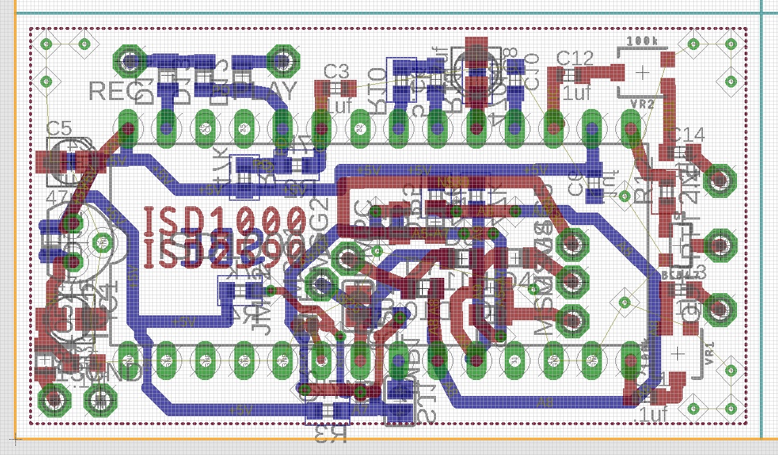

I use Eagle CAD and have my boards made by SeedStudio in ShenZhen, by Hong Kong.
