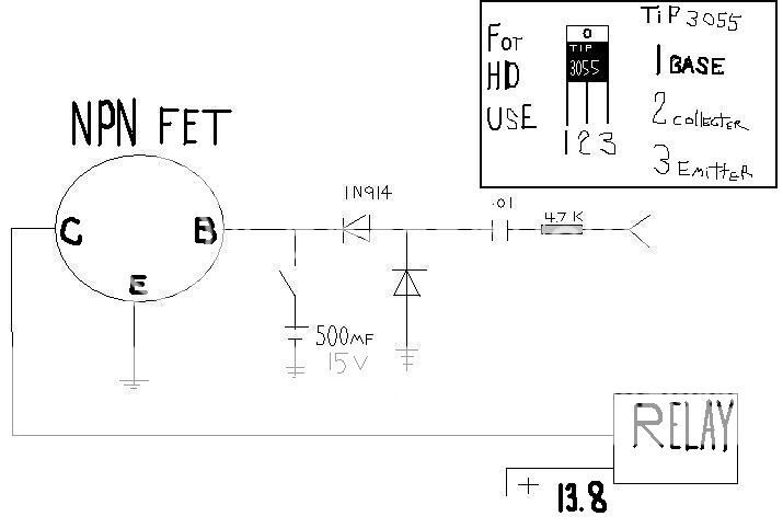

I am looking to switch a 12v relay via pin diodes from two different rf sources to drive a transverter. The relay will direct the one of the incoming rf levels, one at a time to the transverter. One has a 100mW level and the other 2w. Does anyone have a circuit for this handy?
Thanks for the circuit and the video link. Very interesting video and I will definitely delve into that a bit more. I built up a Ultimate 2 transmitter unit to drive my 472Khz transverter but silly me, I forgot that I would need a another receiver in the same box. The transmitter has an atmel chip programmed with changeable data for various modes and around 100mW output.
I used to use my HF rig to provide the drive at a 2w max level and using the wspr software. This worked fb, but hogged my hf rig. Well I have a starting point now, but will need to also build a receiver. Ho hum, its never that easy is it.
