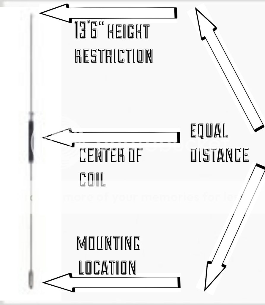

Regarding that monkey made antenna that's 7 feet 10 inches long, where is the coil in relationship to the top of the stinger and the bottom of the shaft?

Unfortunately on the Freightliner Cascadia it needs to be angled slightly to get a decent match because if you make it completely vertical, half the antenna is running parallel to the side of the truck and it causes the SWR to go through the roof. The shorter the distance from the bottom of the shaft to the bottom of the coil necessitates greater angle to bring the coil away from the door pillar.
