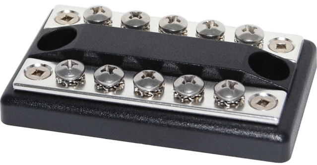

    Anybody know where I can get a 12 volt power strip? Looking for something I can hook my power supply to and power multiple devices without wires going everywhere.

    I like MFJ strips for their convenience. They make it easier to swap components in and out without disconnecting the entire harness. As far as the neatness issue is concerned, you will still have the same amount of wires to deal with, plus one, the wire going between the strip and the power supply.

    We used those extensively to distribute 5 and 24 volts throughout our studios for relay control. You just need to jumper all the terminals on one side to make a common rail.

    They have those made out of stamped metal, just loosen the screws slip it in and tighten them back down.

    The mfj is what I was looking for,thanx.

    I’m not fond of barrier strips because of all the needed jumpers. You really need two of those strips, one strip for positive and the other negative. Dual bus bars run about the same price and solve that issue. If you want frugal, this is the route I would go. This marine item from Blue Sea Systems makes both 5 and 10 gang versions of these and will handle 100A. bus bar.jpg
