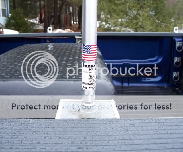

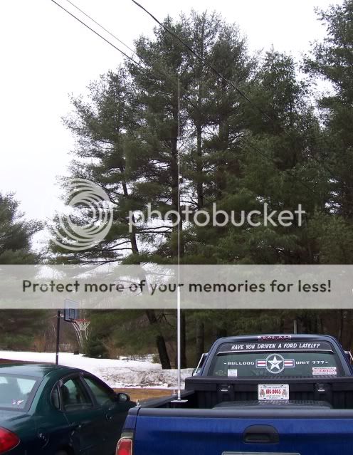

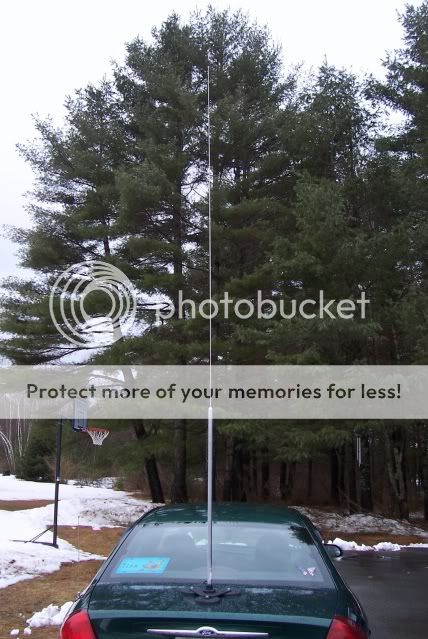

I have been a loyal 102" stainless steel whip user for years. Simply because this old time classic has what it takes. Well I have a customized truck and it was time for a change. Went with the Predator 10-K with a 22" shaft. Now that antenna compared very well to my 102's. I expressed for something different once again and got it. Kale Cavel of Cowtown Antennas let me know what some of the guys were doing in the past. Well to make a long story short Kale made a 7/8"X36" aluminum shaft. Then I was to cut and tune from a 102" whip. In the end resulting with an antenna that tunes well, firmer stance especially at highway speeds, extremely low refective SWR, pleasing overall appearence and awesome performance. When doing a swap in and out test between the standard 102" and the Predator Freedom 1-K I noticed that the antenna with a combo aluminum/stainless steel did better on the swing. Kale told me He don`t know why, but for some reason, if you put a whip inside a tube it works better.I have no antenna anaylzer but done several usage tests. Well with a K40 heavy duty stud mount with a brass center, custom bed rail L-bracket and 21' of Belden RG-8/U coax with silver plated teflon insulation PL-259's this set up provides the best performance. I found the performance range is 25-35 air miles. Have not had a chance yet to test it during DX conditions. Have a pretty near 1.1:1 match and pretty happy with this antenna. Below are some pictures and I welcome any comments. Remember I am still learning about antennas of this caliper.
When doing a swap in and out test between the standard 102" and the Predator Freedom 1-K I noticed that the antenna with a combo aluminum/stainless steel did better on the swing. Kale told me He don`t know why, but for some reason, if you put a whip inside a tube it works better I have no antenna anaylzer but done several usage tests.

"I noticed that the antenna with a combo aluminum/stainless steel did better on the swing."
i know that most meters just react to whats on the other end of the coax (and the coax if its dammaged or not assembled correctly) and that when you change whats on the other end what the meter will show will change too . considering you have to double power to start to tell a small difference on the other end id thing what ever little extra swing the meter showed had no detectable difference on the recieved end .
also both of the antennas are aluminium and stainless steel . the lower sections on each are aluminium and the stingers are stainless steel .
