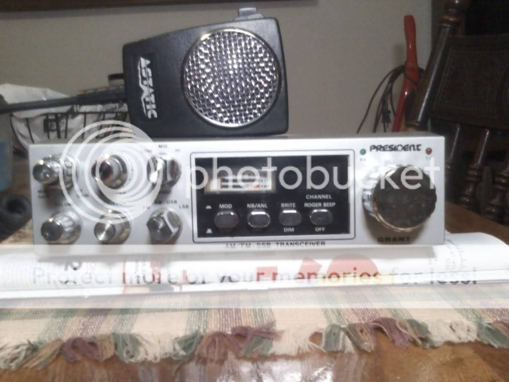

This is the Grant that I will pick up next week ...
the s meter in that grant isn't standard, the grant uses the same typical uniden (nissei made) s meter as the jackson, with mod markings on it. the jackson later variations were 6 bands, early ones were 5 bands.

Good eye on the meter .... That is an easy replacement if I decide to do so. The exterior is in very nice condition which was a high priority for me. It will be used mostly on AM.
