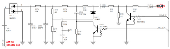

These types of setups have no adjustment - so if there is a particular type of impulse noise - this filter uses averaging to smooth the waveform - but uses inversion to remove the pulses and offers little ability to change the length or duration of the average sample to make the NB effective with any long duration pulse or short duration pulse noises - so you will have to rely on the ANL filter to provide more relief in noise reduction.
You will get white noise - and there little you can do to "tweak" the IF Strips to lessen or even recenter the Xtal lattice to suit any needs - unless you use a hot air station and can work on these SMD types.
It's similar in design to other Presidents - Bill FCC comes to mind - it only has ANL - and that too, has issues with performance under certain conditions.
Reactions: Retro CB Guy
The things got AM and an FM - so here's AM modes ANL - and it is not much...
Then the FM side, the "demodulator" works with ASQ (auto Squelch) - also looks at the 455kHz out - between the two - the AM "detector" and ANL diode including the 330K "tickler" - there is little there to provide a "tonal filter" to lower or change or even reduce the white noise prevalence the thing will have thru its speaker - you can make changes , even add parts but the things gonn'a look like h*ll once all the passive filters you'll need to add in to this line once done - to make it worth it.
The above is the "FM side" - but wanted to advise you that RF AF and RX IF - share lines between both modes. This can inject "air noise" from the signal it's awaiting to hear. This also adds another problem - remember FM when you DONT hear a signal is nothing but white noise - so the ASQ kicks in to reduce this level.
Why would this be a concern, in AM mode - FM demodulator is not used, it's muted - but not turned off - so you'll hear its noise as the AM side works, the muting is only good as the components used to "mute it" - just so you know.
