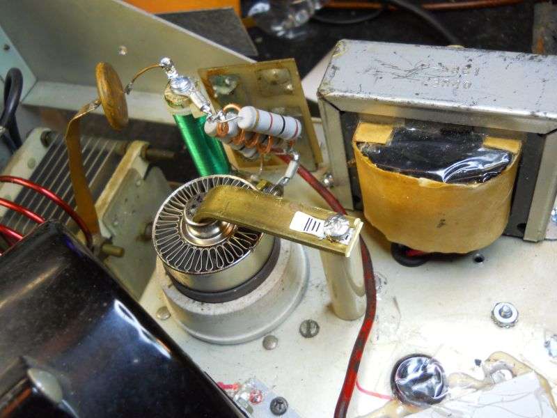

Here's a hack prompted by frustration.
Sent this Pride DX300 home with the owner after replacing failed circuit boards. Owner reports it won't do anything when he got it home.
Found we had sold him a bad relay. New relay made it work like it should. Sent it home.
Called back, says it won't do anything. Dern!
Brought it back, couldn't duplicate his problem. It worked first time, every time for us.
Puzzling. Then again, first thing we do when this model gets evaluated is pull the tube and see what the tester says about it. This is cheap insurance, since a tube failure tends to damage components in this model. Tube tested just fine. The amplifier works like it should, can't make it fail.
Took it home the third time still no wattage. Brought it back. Gotta give this guy credit for still being friendly even after the third time it took a dump on him.
This suggests that the tube has been coming loose in the socket. The pins on the 4CX250 tube are small, and the tube is top heavy. There's just not enough friction in the tube socket to hold the tube properly square against the chassis deck. And if that was the problem, I obscured it by pulling out the tube to test it before plugging in the power cord. Naturally when I placed it back (squarely) in the socket, this would cure the issue, but not exactly on purpose.
This should take care of the jostle problem. Gonna have to locate a supply of 2-inch tall ceramic pillars, or maybe just make my own from teflon dowel. Leads me to wonder if it's an upgrade we should perform routinely. Ceramic pillars have been getting expensive lately.
This looked like the simplest solution. With any luck he can finally get the thing to work for him once he gets it home.
