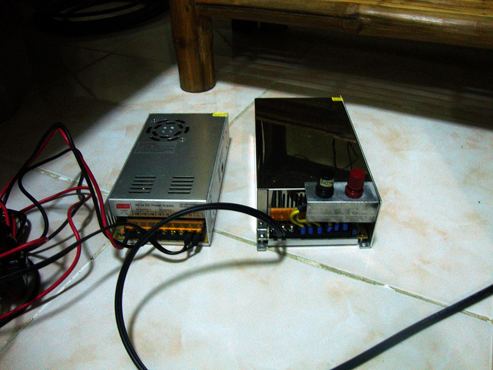

A few of the WorldwideDX.com members made me aware of some small, inexpensive switching power supplies being sold on Amazon and eBay and they swore that they were free of hash. After my unbearable experience with the MFJ-4275MV supply (original thread here), I was curious to find out myself if the $30, 30 amp switching supply on Amazon made for a better operating experience.
This is the product that I purchased on Amazon:
Amazon product ASIN B00D7CWSCG
And this is the MFJ-4275:
The Amazon unit doesn't come with a power cord, but must of us have those laying around to sacrifice. After wiring up the AC, I also wired up a DC cord for the rig, complete with Anderson power poles.
The first thing I wanted to find out was how bad the hash problem is on the $30 Amazon unit. I turned on the NaP3 Panadapter, used with my Elecraft K3 and took a print screen so you can see the hash present on the MFJ supply:
Note the circled slanted lines - that's the interference you will hear in the RX present on any of those frequency ranges. It sounds like a whistle going by and is quite loud.
This next screen shot was taken only minutes later after changing the rig over the the Amazon 30 amp switching supply:
As you can see, all of the slanted lines are gone. I've been using this supply for about three weeks now, and no matter what band I'm on, I hear no interference from the supply - a night and day difference from the MFJ unit.
I also developed a problem with the MFJ with the voltage varying significantly every time I turned it on. I had set the supply to 14 volts, but found it as low as 11v on occasion and as high as 16v! So far, the Amazon unit has consistently held the voltage I set it at (14v). I do notice about a 1v drop under transmitting at full power with the Amazon unit, but that is about the same as the MFJ supply.
All told, I couldn't be happier with this little, inexpensive supply and haven't found a reason why anyone should spend more money on a more expensive unit.

Thanks for the review. My megawatt s400 has performed flawlessly as well! Might have to get one of the units like yours just cause they are so inexpensive! They do work well for the money and I believe megawatt or someone makes the proper part to run 2 or more in parallel. Tallman I believe runs a couple of these In parallel and has had good luck with them, he uses the s400 megawatt units but they are the same unit as what you have minus the power cord. Again thanks for the review Moleculo! God bless.
The only switch mode power supplies I have run on my bench is the MegaWatt 400. To run two of these in parallel you need the diode isolator. You have to keep the power supplies from trying to regulate each other.
MegaWatt has higher output units now that they did not have when I bought mine. For the price you pay for these are well worth it in every way you can imagine.
Two years and not a single problem with the power supplies or the diode isolator.
I also use one of these and haven't had a problem with it in the 1 1/2 years I've had it. I originally ordered two with one for a buddy and one didn't work. I sent it back got another and works nicely with my 98vhp.
I have owned the megawatt 400 watt unit, the first one I had got taken out by lightning, the seller offered to replace it for the cost of shipping, like $10, like any cheapskate ham I took him up on the offer, , then I later sold it when I sold my first HF rig... the new owner says it is still working well
I bought another one when I got my 857d... I love it, works perfect on all bands
it may not have fancy connectors, or voltage readouts or be able to love me long time... but it does the job and it does it VERY well
I'm still on my original Megawatt (2 years now I think or more) and it's worked flawlessly. Can run any 2 pill amp, radios, etc. No voltage drop, no hash, it's amazing to me to have something so small after years of big, heavy power supplies taking up all my desk space.
