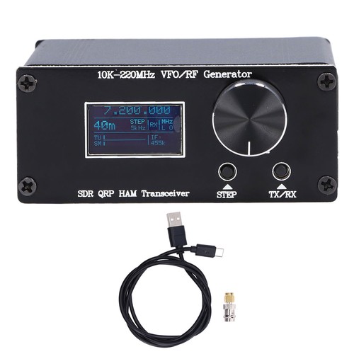

I was wondering if anyone here has fooled around with the programmable oscillators. I see a youtube video where someone used one for a cobra 29 for extra channels.
Was wondering since crystals are very hard to find and cost too much if one could be programmed for say 11.4758mhz to be used to get high channels on a pll 8719?
Also will it swing enough to give 2+- kc tune for ssb.
These seem to be much cheaper than having crystals made.
The prog-osscillators are a one time program and you can set all the parameters with the program menu.
Here is a page from a company with the programmer.
