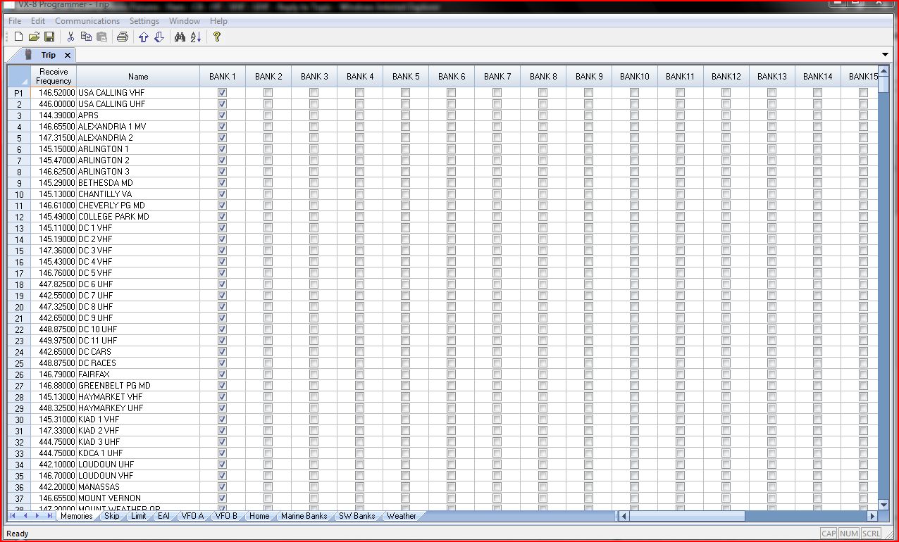

There is a memory bank screen where you can add the memories real easy and arrange them however you want. as far as moving them around I'm not real sure what you mean. I attached a screen shot of the Memory Bank screen
