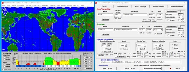

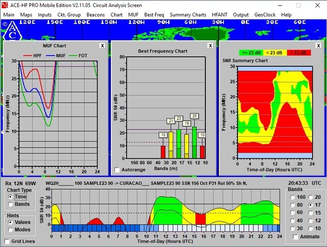

I've been using ACE-HF since 2017 and I like it a lot. It can run propagation results for multiple points, using multiple antennas and antenna orientations, with different power levels and modes, and then list MUF, Best Frequency, SNR Summary charts, and give you a band/performance report. It is a powerful program so I would recommend going through the HELP.PDF file (located in c:/ACE-HF after installation).
Below is a summary of a recent WQ2H to PJ2BR analysis. You can also build and add you own antennas to the 'antenna library' and keep a predictions library of frequently used call signs.
