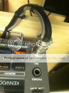

Hey ratsoW8, I see you are running ts140, or it looks like it. What mic are you running? Just curious. Any way you could post a couple photos? Thanks much and not trying to hijack the thread either. And hello there Hobie102!! Just curious. Again thanks much and God bless.
222...It is a TS-140S and I'm using my trusty Heil GM4 with it. I've used that GM4 on every HF radio I've owned since 2001. I'll add pics to this post when I get home tonight. I'm going to be buying the new Yaesu FT-991 but will keep the 140S. It has a great general coverage receiver.
