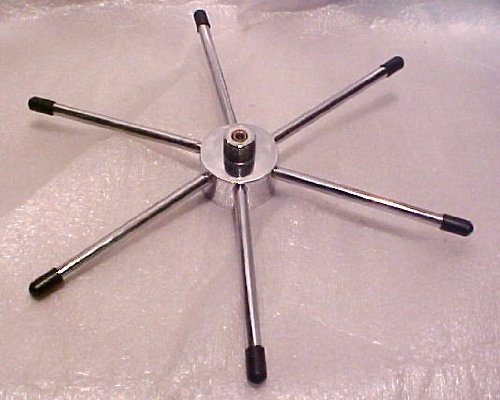

Your talking about something like this it does not to improve your receive one bit it is just for looks. It does change your swr a little since it makes your antenna a little longer.

Kale made a few "Ground Plane Kit's" for the Predator 10K a few years back, that had 4 - 2' radials. The kit went under the coil...You just unscrewed the coil fro the lower shaft, then screwed on the ground plane kit...I have one somewhere around here...Only benefit I seen with it was it gave the birds another perch to sit on.

Couldn't remember where I stashed that ground plane thing...But finally found it! The radials are shorter than I remember, about a foot on each side...Kale only made a few of these...So guess you could call it a "Limited Edition".:D

Those could be ground radials if they were mounted on the ground side if the antenna but they are not.
Instead those are more like improperly placed capacity hats. If the rods were at least on top of the coil they would be effective. Cap hats should be placed at the top of the antenna just as the name implies, you put a hat on top of your head, right? Not pratical with a coil/ whip antenna for stability though.

It can also be placed over top of the coil by unscrewing the top section from the coil...but doubt that would work any better...no way to use it like a cap since there's no way to attach it to a stinger...Like I said tho, he only made a few, and those never went on the market for sale.

That's basically what I already said. There is a reason why it wouldn't work better even if the 2 sections were reversed. Do you know why?
