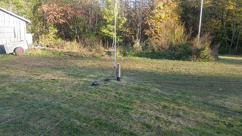

After being off the air for far, far too long I did something today I never thought I would ever do.I installed a trapped vertical antenna. ;P After having spent my entire radio life with rotary directional antennas I broke down and ordered a 5BTV to get me thru the winter. Desperate times calls for desperate actions I guess.The final straw came a week and a half ago when all I could do was listen when Bill, ZS6CCY, was thundering in on 40m about 20dB over 9. It went well as I had preassembled a few parts last night like the traps and a section of tubing, the base mast with the direct coax connection conversion and a home made radial plate. It tuned up fairly well with 40m being a little higher than I would have liked but still usable across the entire band. 80m is quite narrow and sharp but centered on/about 3785.10/15/20m are all great. I forgot to install the 17m add-on kit so that will come in the next couple days. So far I have 26 radials each 33 feet long and not exactly evenly spaced but there is more work to be done with them.
Newly installed Hustler 5BTV minus the 17m add-on kit. I forgot it initially and then ran short of time. It will be installed in the next day or three.
Antenna base and radial field. So far there are 26 radials each 33 feet long. More to come.

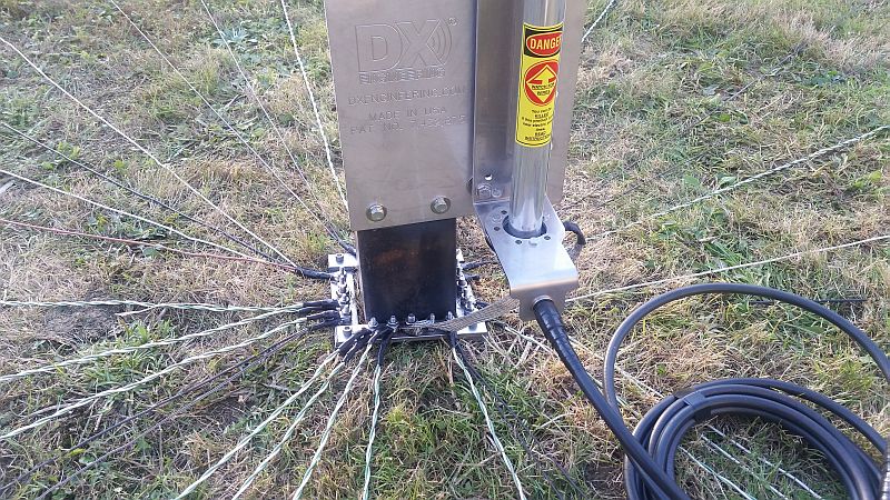

Antenna base with DX Engineering direct coax connection kit and tilt base.

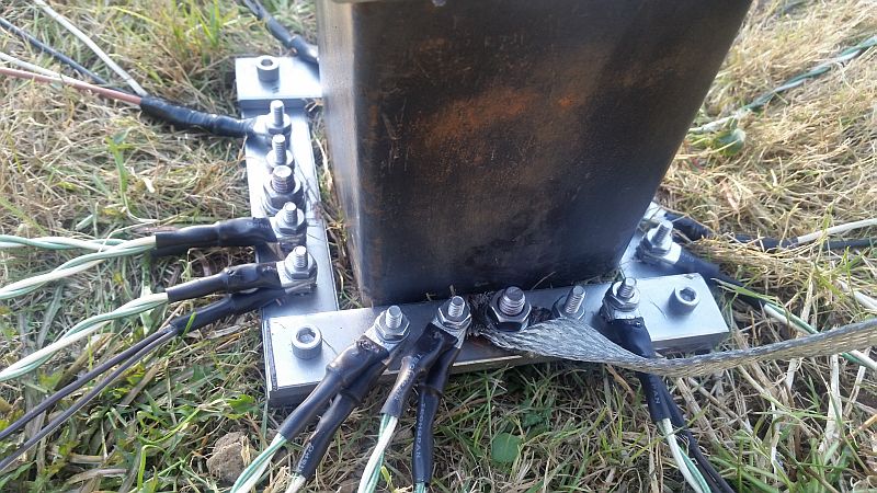

Home made all stainless steel radial plate. All radials are crimped and soldered to lugs and attached using 10-24 stainless hardware.
What effect does 2 feet of snow have on the performance of ground mounted verticals?
No idea yet. Generally it is not a big deal. The base is a low voltage point and snow should not be an issue. The feedline is sealed good and even if snow touches the antenna the first day of sun shining on it will melt it back.
Thanks. Always wondered about that.
