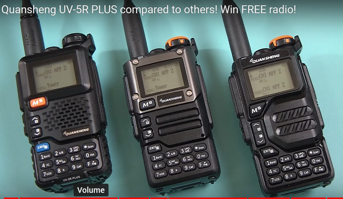

I ordered their latest version, a Quansheng UV 5R Plus for $18USD shipped from China. Supposedly improves on the AM reception on Aircraft frequencies but I don't listen there so ... the SSB hack will suffice. 18-1200 MHz coverage here we come.
