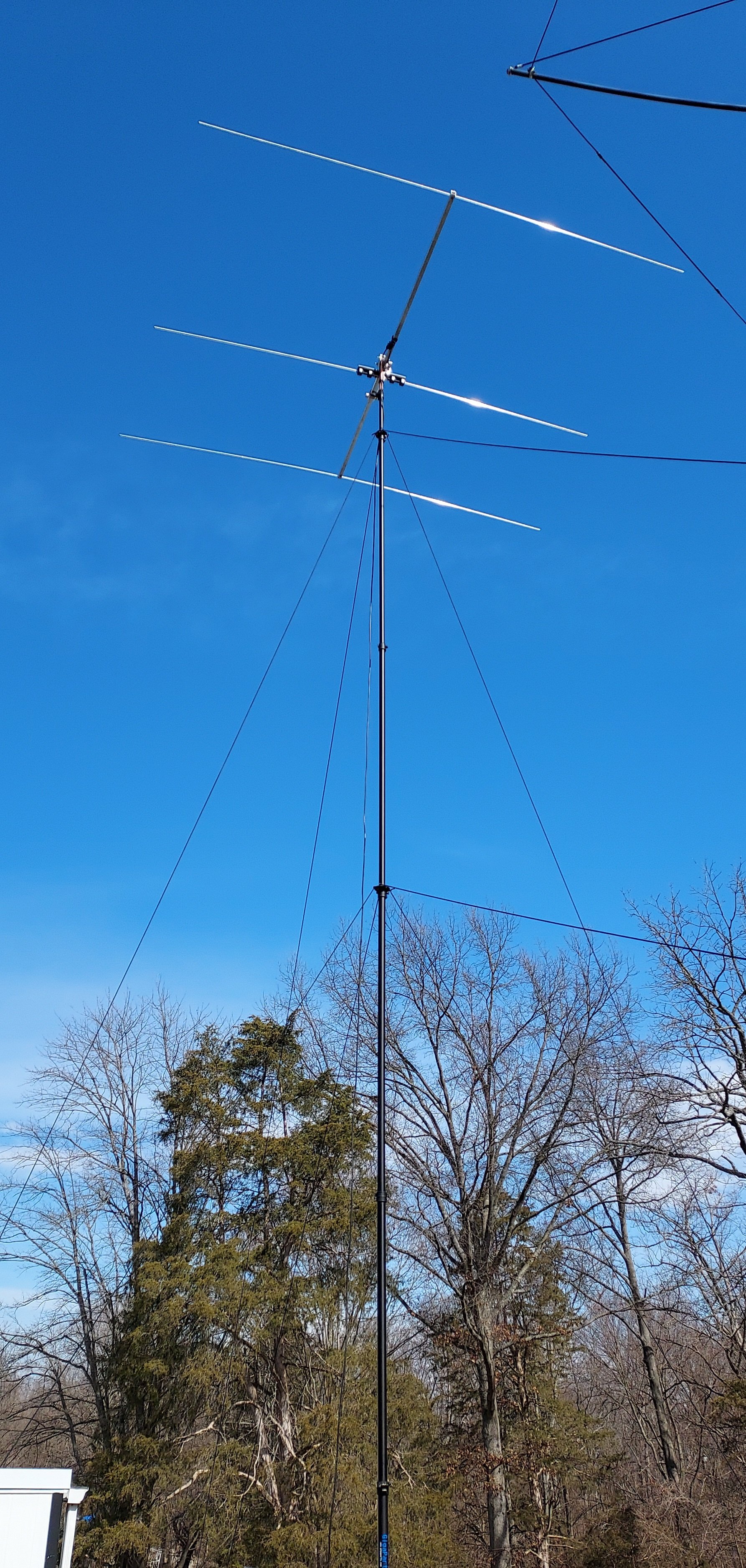

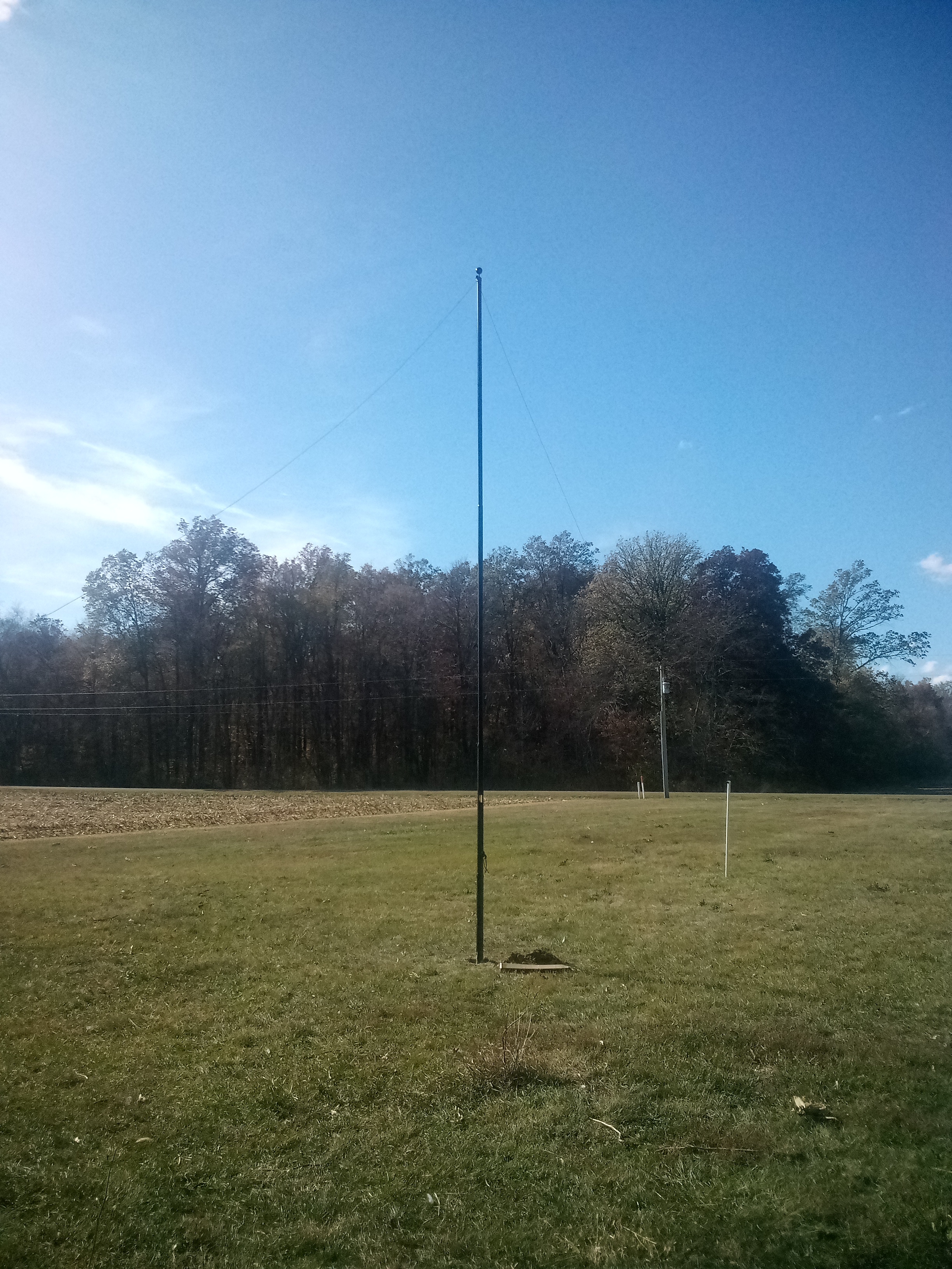

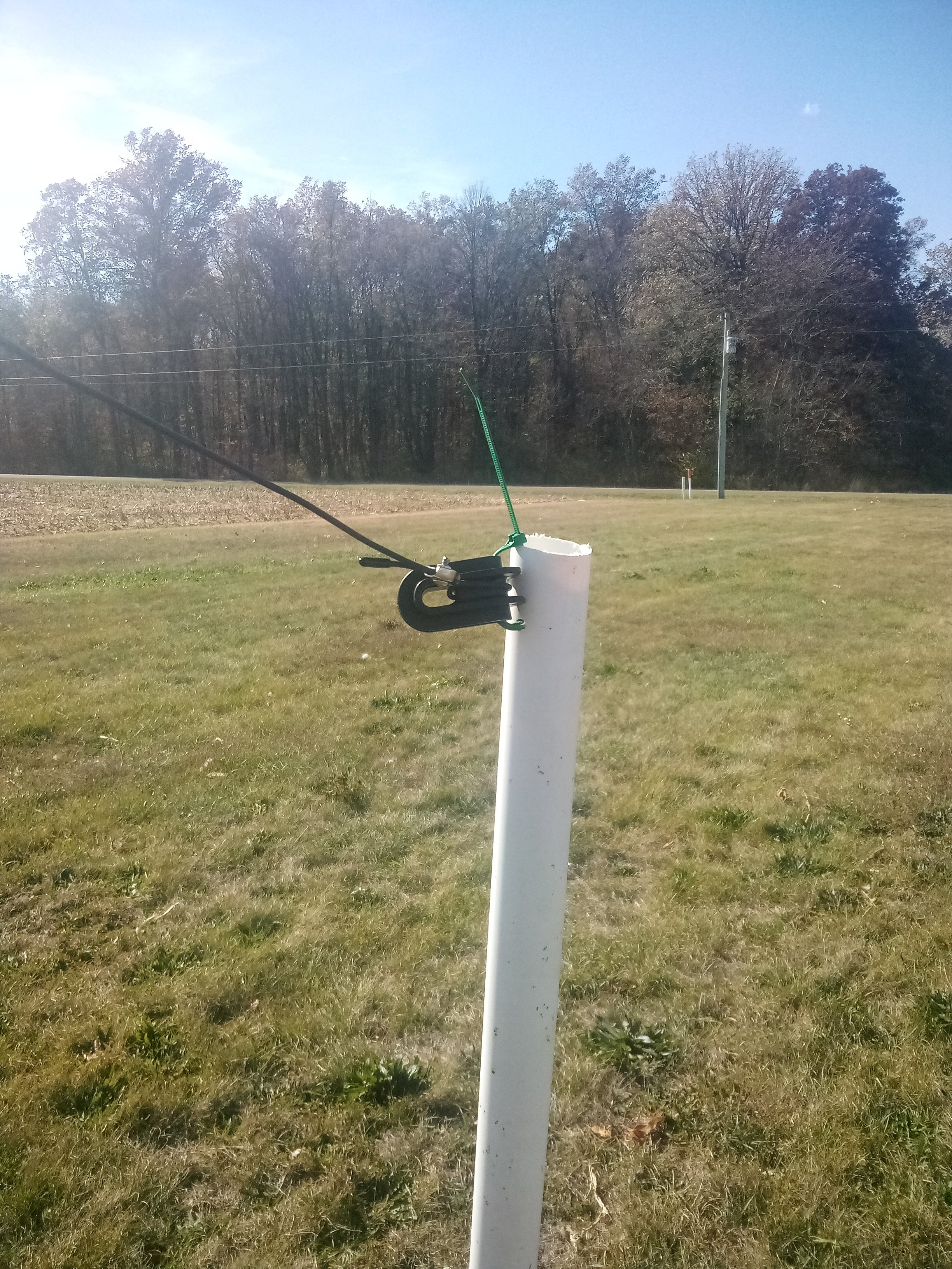

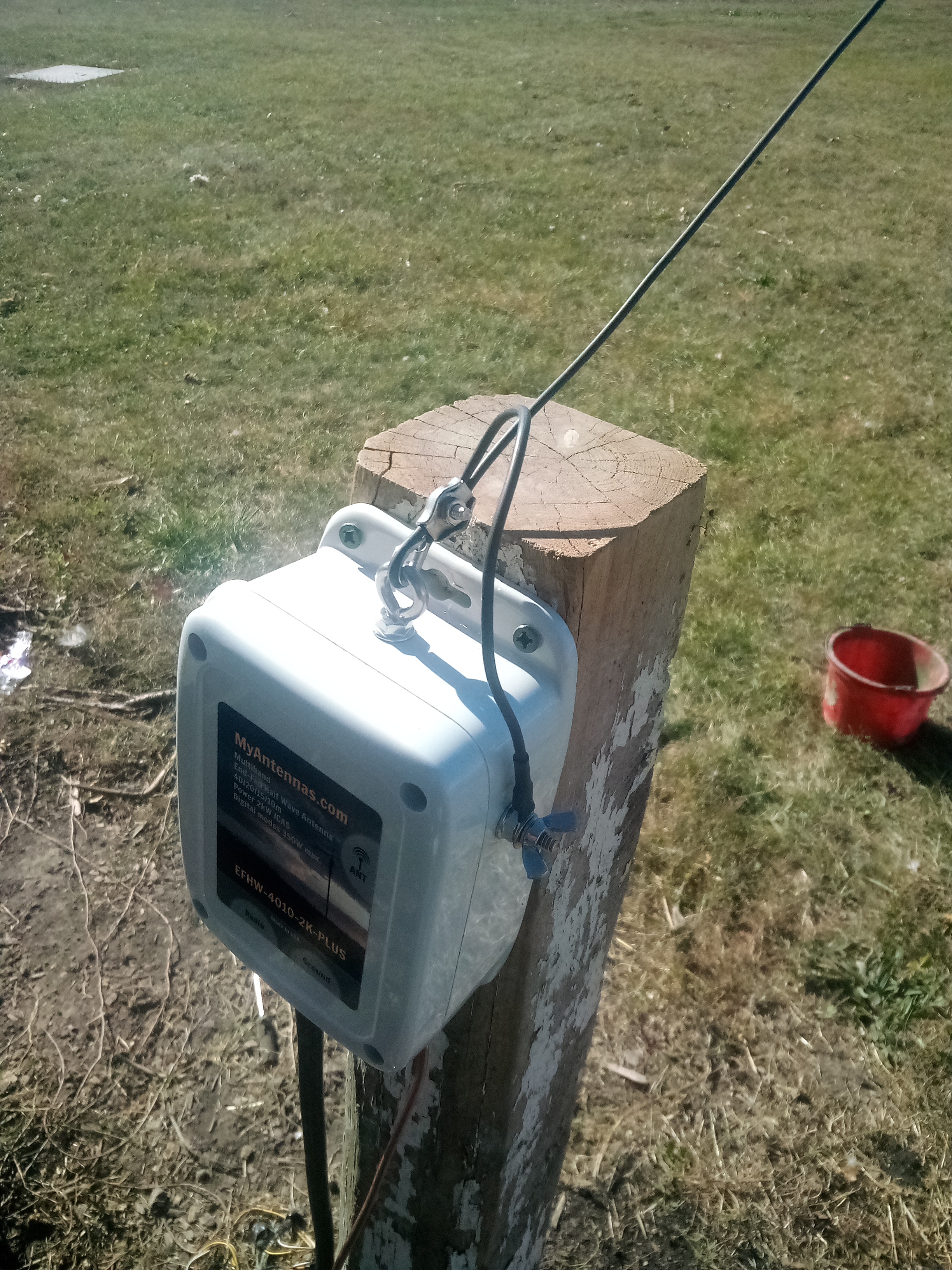

Bought a flagpole mast and a 4010 2k plus from My Antennas. Works very well with relatively low SWR on all bands.

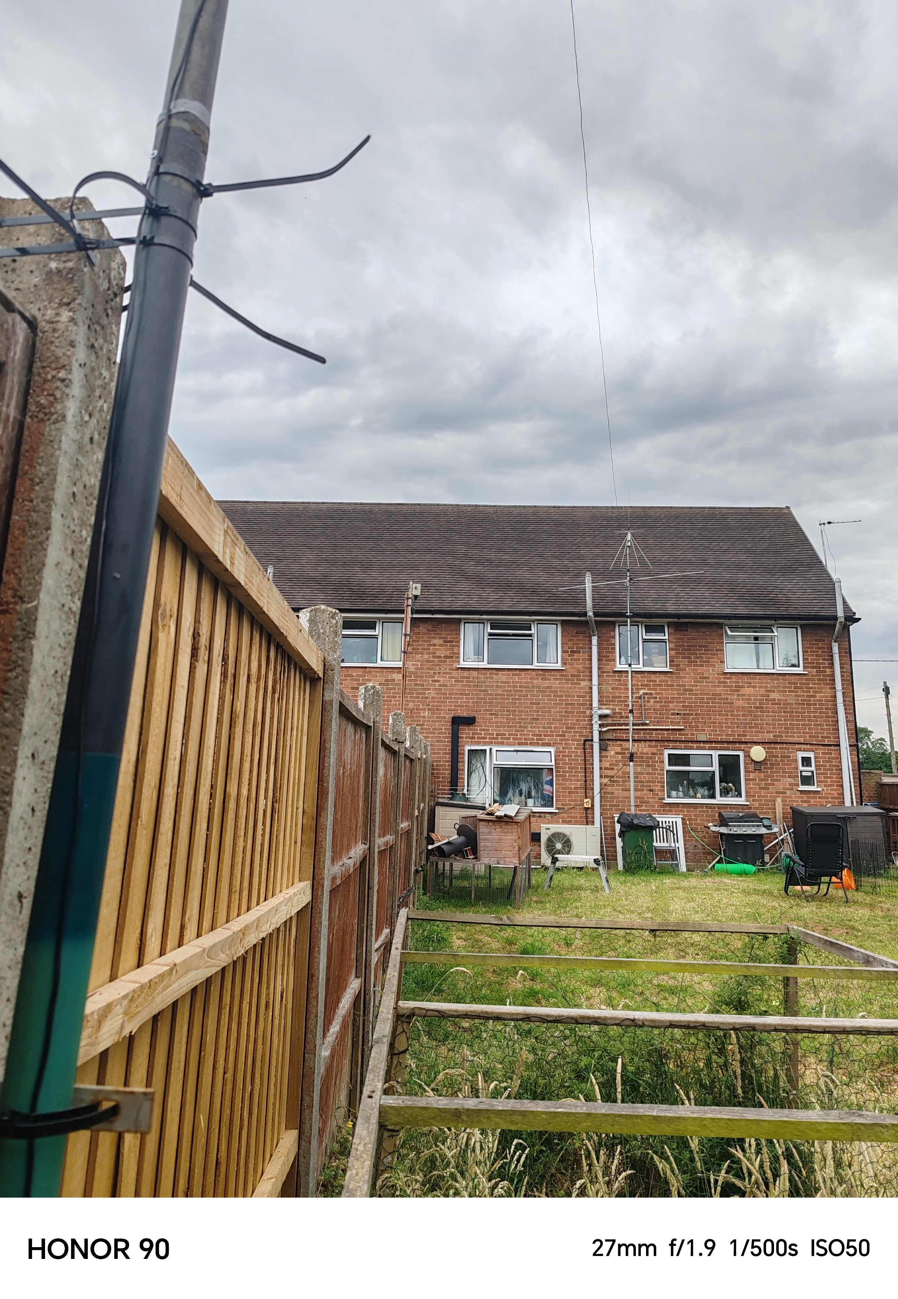

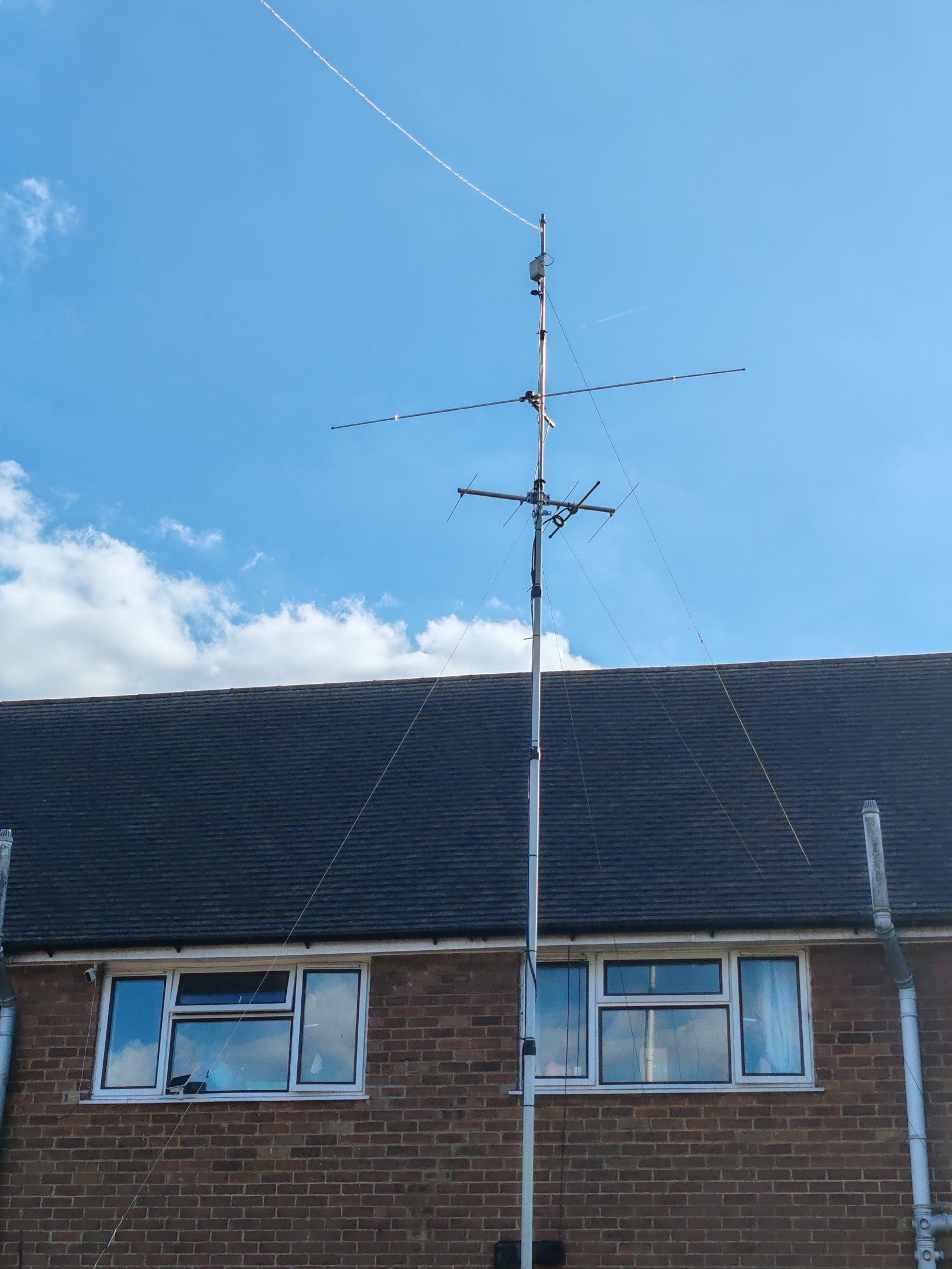

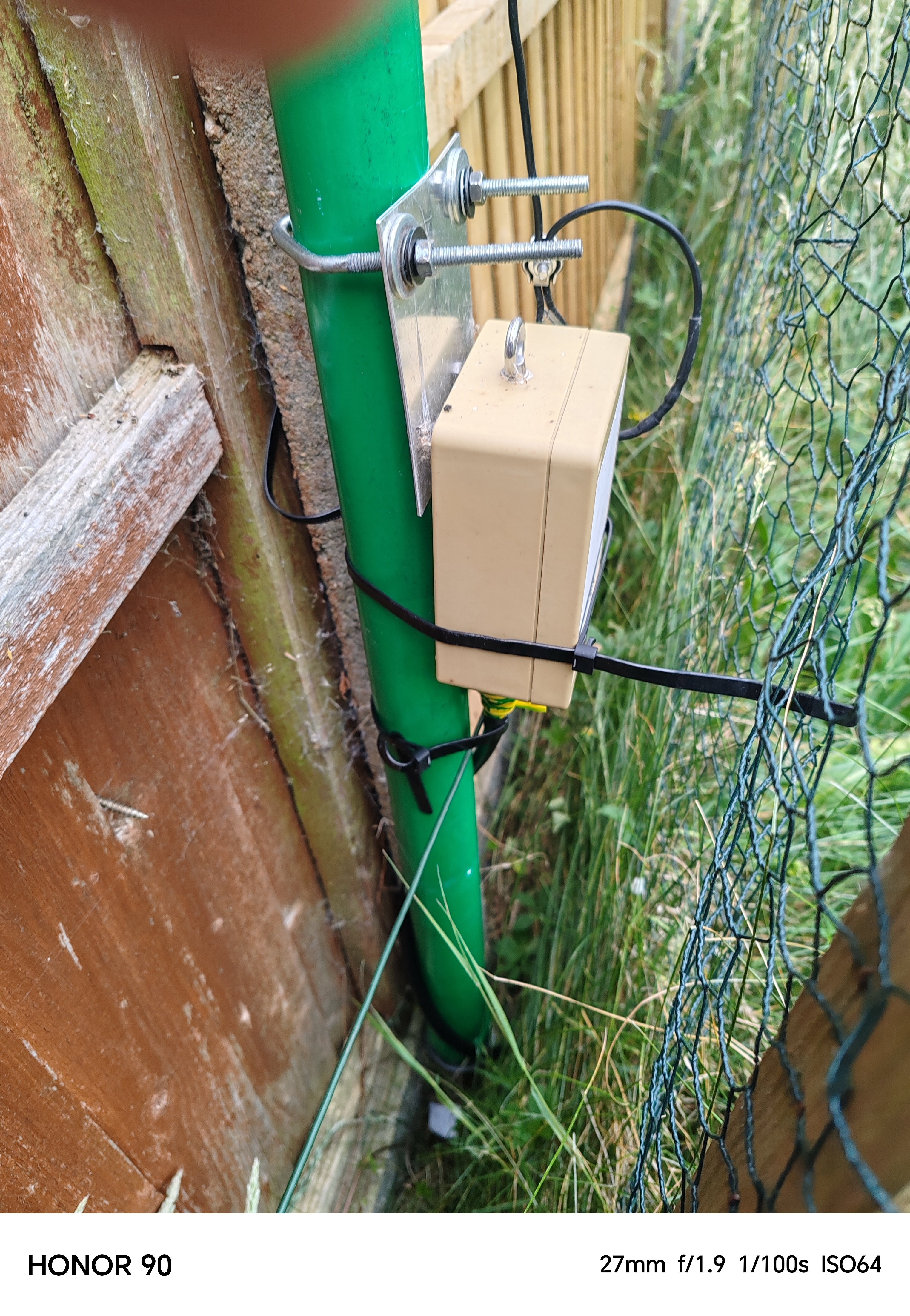

I use a fibreglass telescopic mast (50ft/15m at full extension) and it is pretty good. I usually have it up around 7m and 3 guys made from 2mm Kevlar (very strong). The base up to about 3ft/1m is secured to a weighted wheelie bin, so I can easily move it around). At the far end of my garden, I have a telescopic fishing pole (a 10m one but only using the first 6 or 7 sections to give extras strength. I run an inverted L (actually a 20m EFHW, with the UnUn at 1ft/0.3m above the ground. 2.1m counterpoise run at 90 degrees to the pole. Wire from UnUn runs up pole then across to the main mast. There is a bend in the fishing pole but the wire itself has no unnecessary tension, and is allowed a certain amount of line sag. This works really well, even with just 50w I work around the world on all modes (just this week, amongst many Europeans, I worked 6O3T, S01WS, 7Z1AL, C5R, 9Y4DG and 5R8IC on 10m; K1JX on 60m and TF5B on 30m, using a mix of FT4/FT8 and CW; plus 100 stations on SSB over the weekend. Had I felt better I could have worked many, many more on SSB. I would advise you to go for a fibreglass/glass fibre (fiberglass) mast, preferably telescopic as it is more versatile than a fixed metal tower/mast/ Also you can use the mast to run a wire up without worrying about the metal of the mast interacting. 'Spiderbeam' do strong masts at heights up to 18m/60ft. DX-Commander sell good poles too. My mast is a generic one, model number is TMF-3, IIRC purchased from one of the larger emporiums over here. I will try to attach some images of the antenna setup, hopefully it will let me. Let me know if you need any more info and I'll be glad to help. 73
