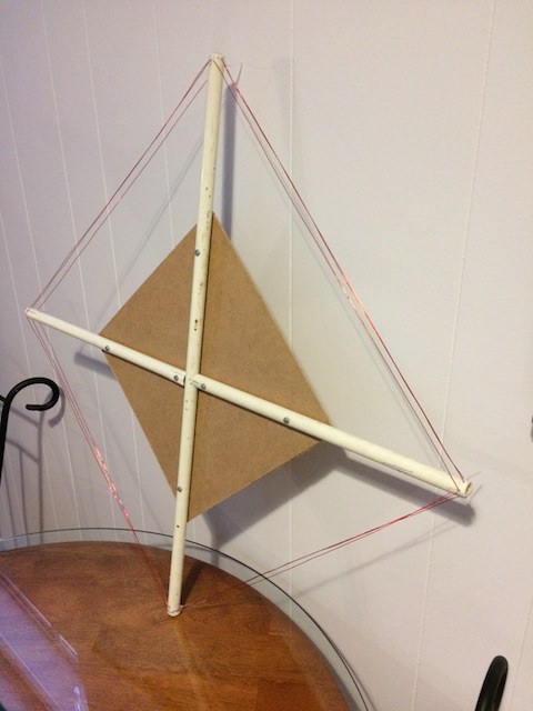

https://www.gigaparts.com/mfj-1020c...MIi5DZvNaq2AIVxCOBCh0GqAywEAQYASABEgJccfD_BwE
If you want to get fancy...these work pretty well for something indoors and table top.
All the Best
Gary
Gary,
I saw this online but wasn't quite sure what it did or if I needed one. As I mentioned above, I haven't played with SW since I was in high school, but now that I'm retired a lot of my old interests are reawakening, which means financially I'm probably in trouble.
Keith
