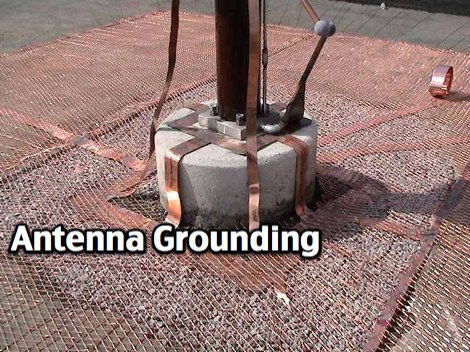

Also at one of our sites we moved in 1986, we made a ground screen about 12-15 feet square out of stranded, bare #6 copper wire. This was installed directly at the tower base. It was basically a screen that we used to help with stability of the ground system in the immediate field of the tower under various conditions, as well as to offer better lightning protection by ground the hell out of the mat right at the tower base. Granted it was #6 but it is still there without any issues. As far as I know.
