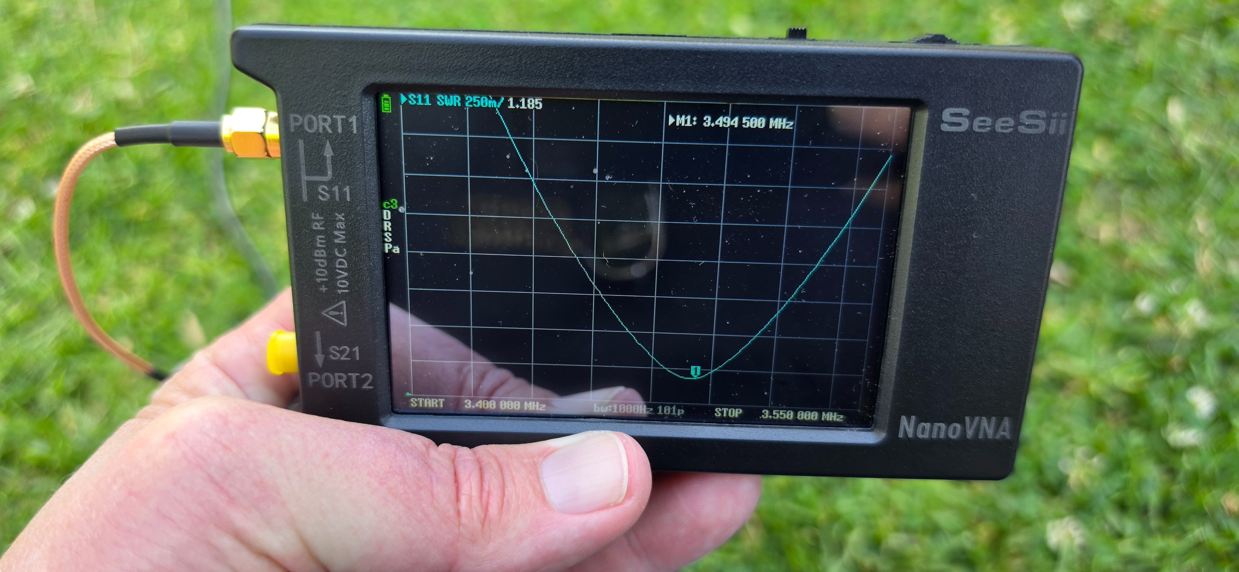

In my first hasty assembly, I adjusted the whip to the length documented in the manual, stretched out the coax and took a reading on my NanoVNA. As I mentioned in part 1 of this review, if you don't have one of these to make field setup quick and easy, you really should pick one up since they're only about $100 on Amazon: https://amzn.to/3QBB3hh. The first reading showed that the low 1.85:1 SWR was slightly below the frequency that the owners manual indicated, but that shouldn't be surprising since a lot of factors will affect the reading on this band.
full
I noticed that the SWR moved around quite a bit depending on how the coax was positioned, which is what happens when it's used as the counterpoise. You'll want the coax as straight as possible; even elevating it a bit changes the reading. I was sitting on the grass and decided to raise the NanoVNA coax end off the grass as if I had a radio in my lap. Once into "operating position", the SWR became stable, but it did interact with my body if I grabbed the coax. These are all the downsides of an antenna designed like this, but on this band, it's really just designed to get you on the air as easily as possible.

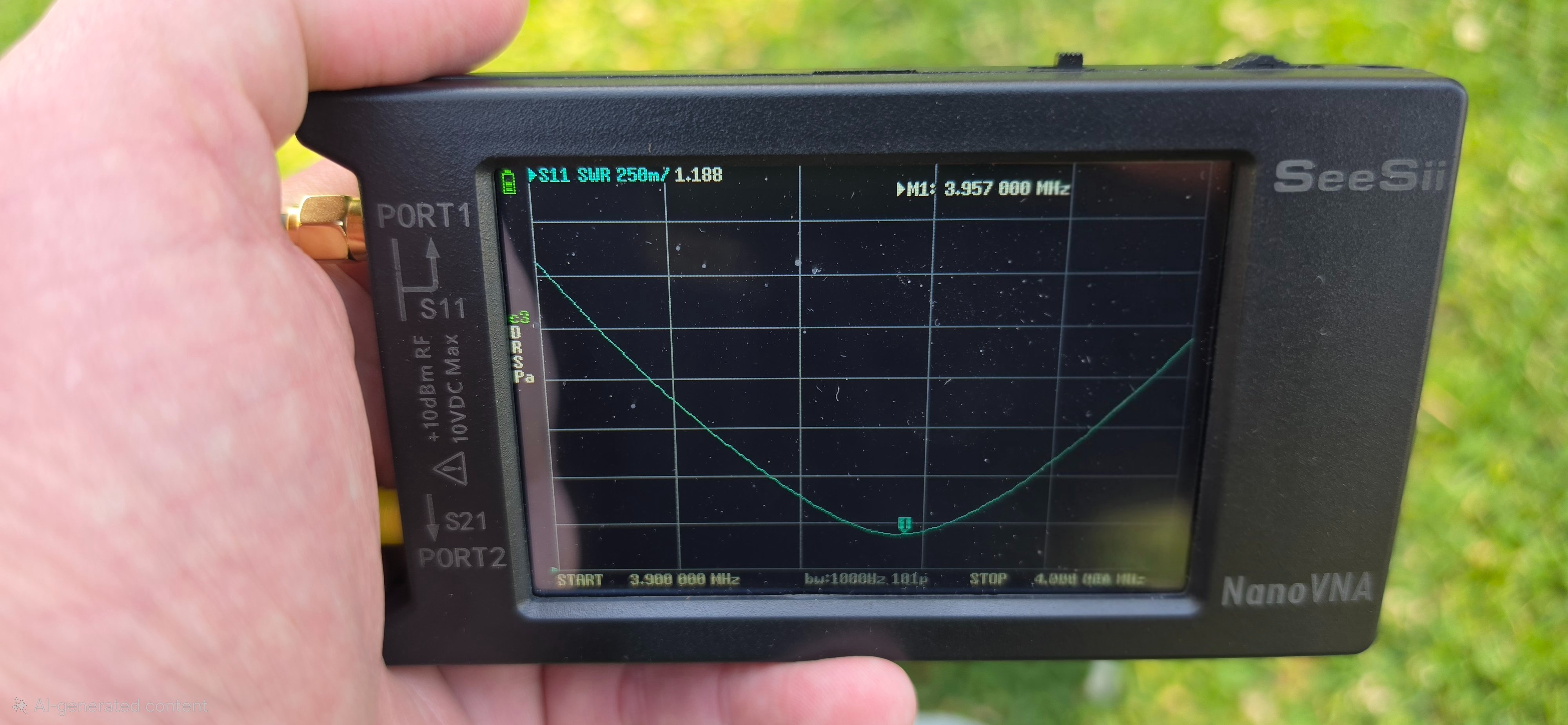

I usually operate in the phone band, so I wanted to see how difficult it is to adjust. All I did was lower the whip from the base until I got the reading I wanted:
full
For this frequency, the final whip measurement was 74", and the meter shows under 2:1 SWR at about 80 Hz of bandwidth. It really was simple to get the SWR to dip down to 1.18:1, especially when you're using the NanoVNA.

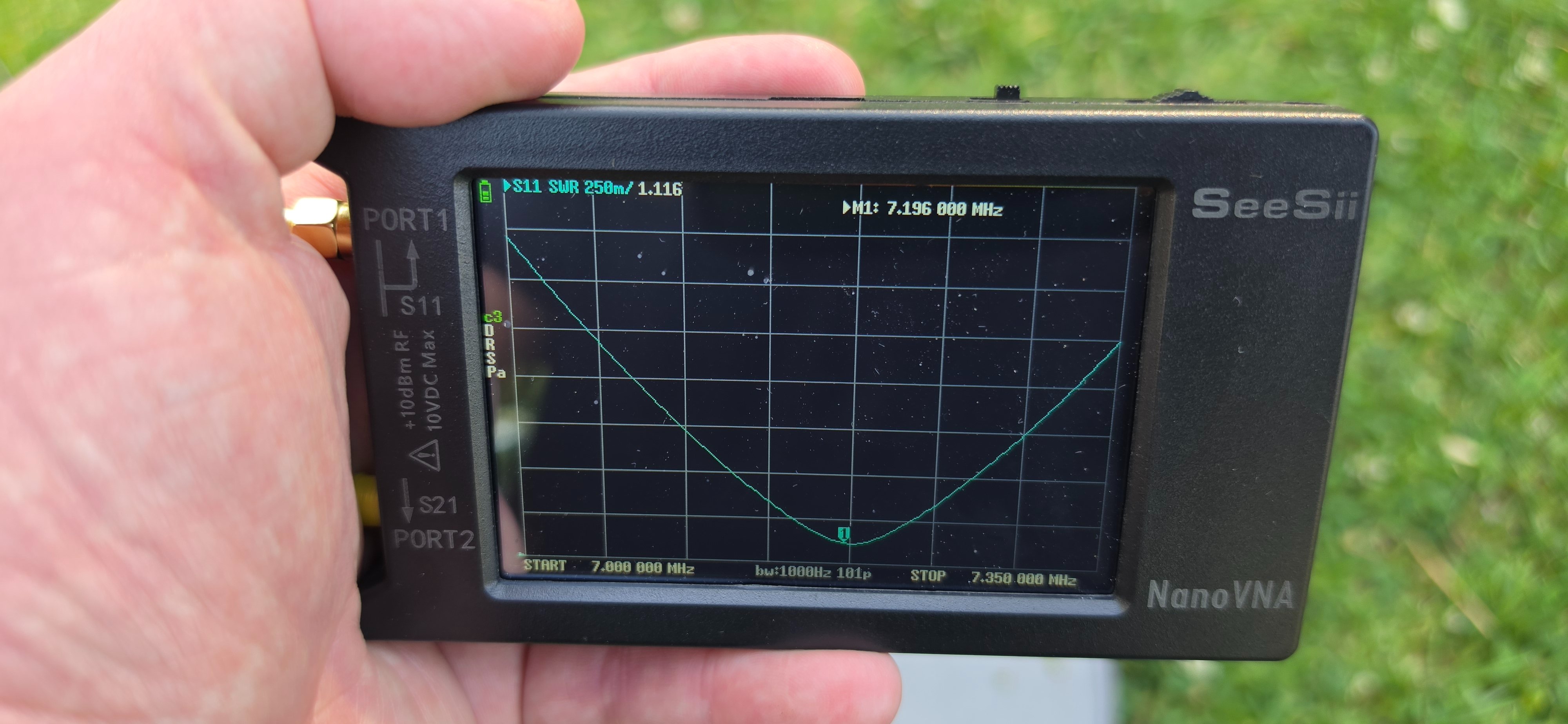

Next I wanted to change it over to 40 meters and take a few measurements. My purpose was two-fold: how fast I could change the band setup and how long it would take to dial the antenna in. Swapping to this band is just a matter of changing the 80 meter load coil for the adjustable shaft / coil, attaching the ground radials and laying them all the way out, and extending the whip all the way up. That operation took almost exactly 5 minutes. I set the tuning indicator as suggested in the manual and then adjusted to where I like to operate while taking readings on the NanoVNA. On 40 meters, the coil adjustment is sensitive but still easy. Within another couple of minutes, I had the antenna adjusted where I wanted it in the phone portion of the band.
full
Here, the antenna is broad-banded enough that it covers the entire phone portion under 2:1 SWR.
