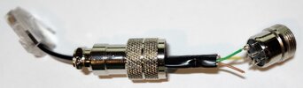

But a strange thing happened when I plugged in my Zetagi MB5 desktop mic and found its modulation first humming in my check radio then nadda. It would not work at all with another handheld power mic I sometimes use either. I do believe I found the culprit, or at least the first culprit, in the little 6 pin to RJ45 adapter I use. Time to dig out the acetylene torch and have at it.

Very frustrating getting older. I just could not see the wire well enough to get it securely reattached. And as a bonus, with my finagling trying to do this, the two other wires are no longer attached. Life it too short to fret over this, time to find a suitable replacement. Let's see, 6 pin mic plug on the Zetagi mic I have converting to an RJ45 for the Anytone/Radioddity radio. Should be some out there on eBay or Amazon already made up for purchase.

The replacement 6 pin to RJ45 plug arrived today and works well with the K-Po NM-532 power mic on both the QT-60 Pro and Q5N2. The QT-60 also works great with the stock mic, very good reports on the sound from it.
However, the same can't be said of the Zetagi MB+5 desktop power mic that was my main mic. It still hums like a herd of angry hornets when I use it with either radio and into either an antenna or dummy load. It had started doing this before I replaced the QT-60 and also before I replaced the cord adapter. It sounds like this Zetagi mic is kaput, or at least quite ill. I may post a question about it on a different thread so I don't pollute this one too much more.
