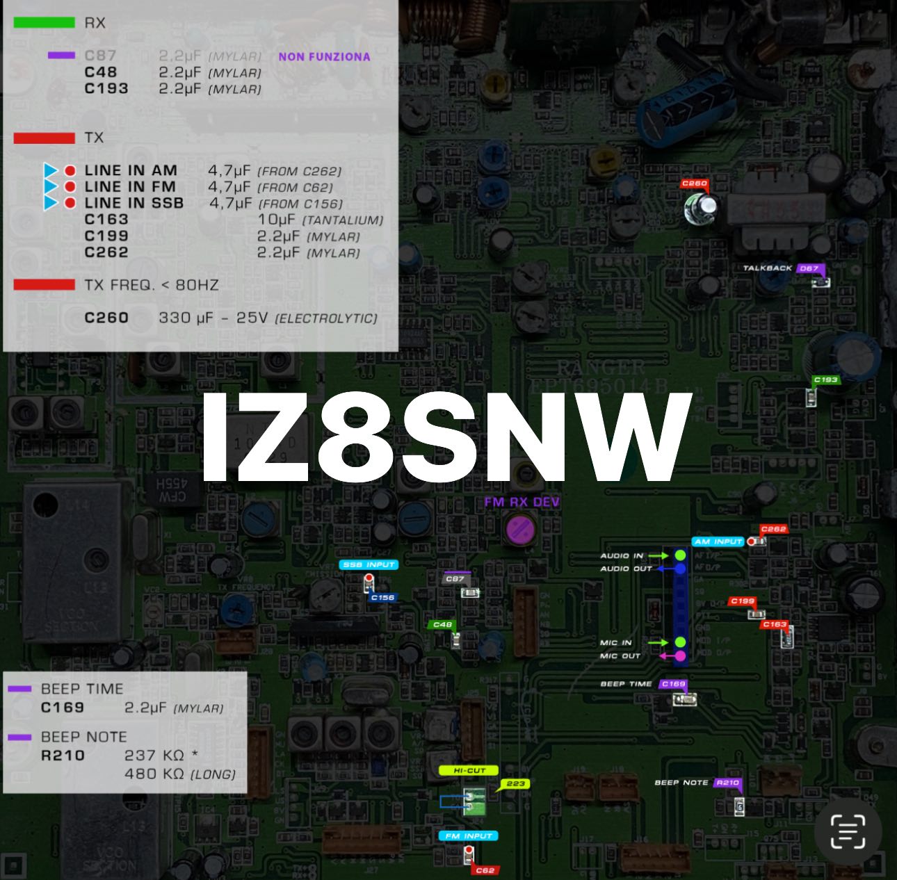

Anyone have the procedure to have this done? My 2995 DX has very bad white noise on both SSB and AM. Thanks for any help.
I do have that modification but will have to look through my notes tomorrow so I don't give you the wrong pads to add the switch. If your photo showed the board a little closer to the front of the radio, I could have pointed to the pads but they're cut off on the photo. I'll get back to you tomorrow unless someone else has answered.

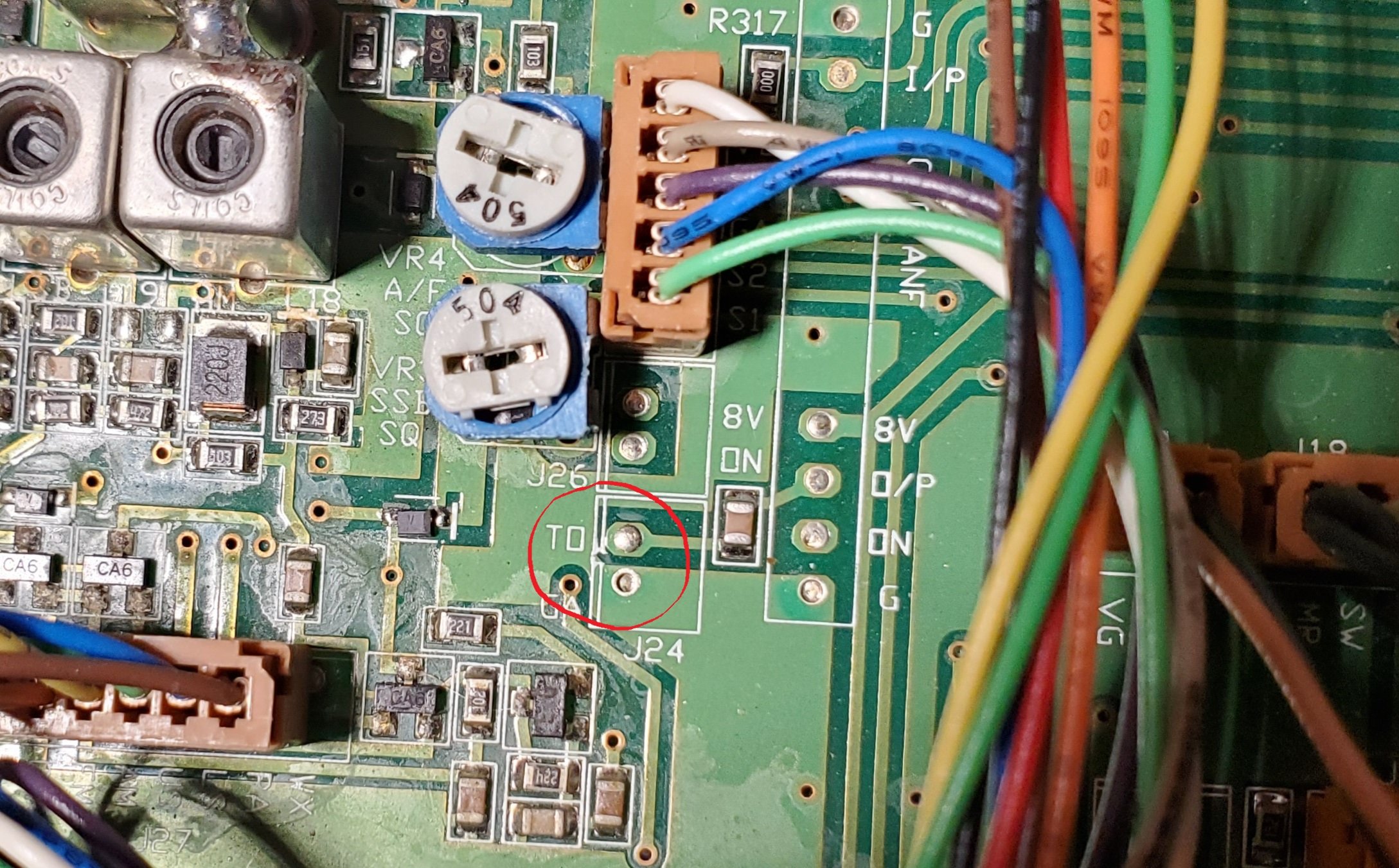

thank you sir I really appreciate it. I looked all over google found very little on the hi-cut mod. I think I know where the switch will go. Circled in red.

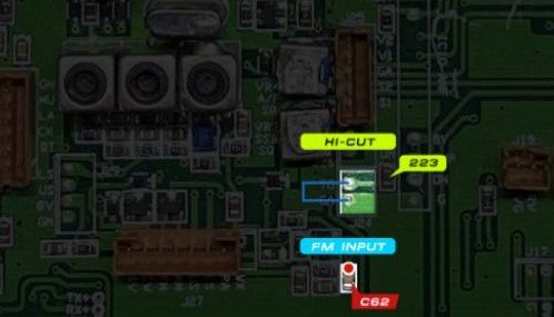

That is exactly where either a jumper or a switch can be put in place. You can actually use a 3 position switch and use a little capacitance to give you a little less or a little more. Off med and high if you wanted.

Before wiring your switch just try whatever disc cap you may have laying around to see what works for you. A 103 maybe. It's whatever your ear desires. Just jumping it through a switch is pretty good i can tell you that.
Thanks Eldorado, got the switch installed and wires soldered in and wow what a big difference. Still not a 100% receive like my 2000 but it is much much better. I wonder if a potentiometer could be used maybe like a 5K
