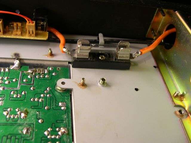

Just be sure to include a 5 Amp fuse, or 6 Amp if it's a MOSFET-final radio in the DC wire that leads to the main circuit board. Nothing wrong with an overkill power supply that will never break a sweat. Just don't want to "overkill" the radio if something were to break down later on.
Didn't take long to learn that this is necessary in every high-power "black" base radio. Won't send one home without it.

Yes. I have already added that inline fuse after other reading on these type base radios. What are your thoughts on replacing the stock 2 wire ac cord with a 3 plonger to connect to the new fangled pwr supply ? Im guessing yes but would appreciate your input on needed / good idea. 73s
