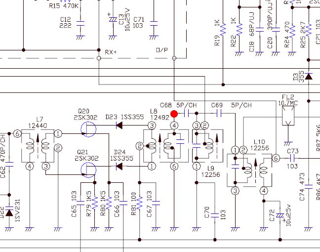

I would like to hook the 2995DXCF to my SDR so I can view while looking for contacts on 10M.
I see a frequency counter connection on the back but not sure if that would work for receive or only during TX? If not can a point on the board be tapped into for this?
Thanks, KB2LMN
You need to take signal from 1st mixer with small buffer circuit.
