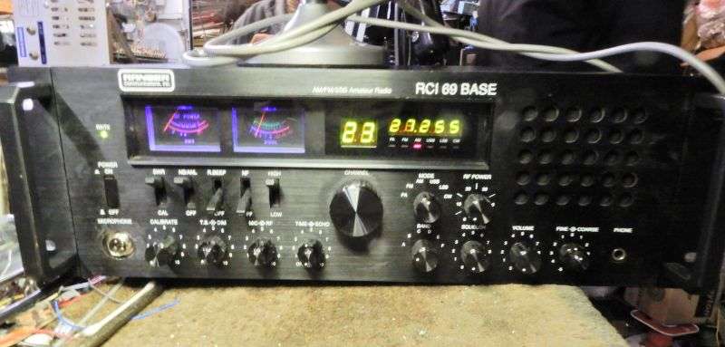

So here's a question. Has RCI finally jumped the shark?
Here's what the latest "Black Radio" from RCI looks like on the outside. Yeah, a poorly-posed pic. Had more important stuff on the plate that day.
Didn't get a lot of other shots before it had to go back together and go home.

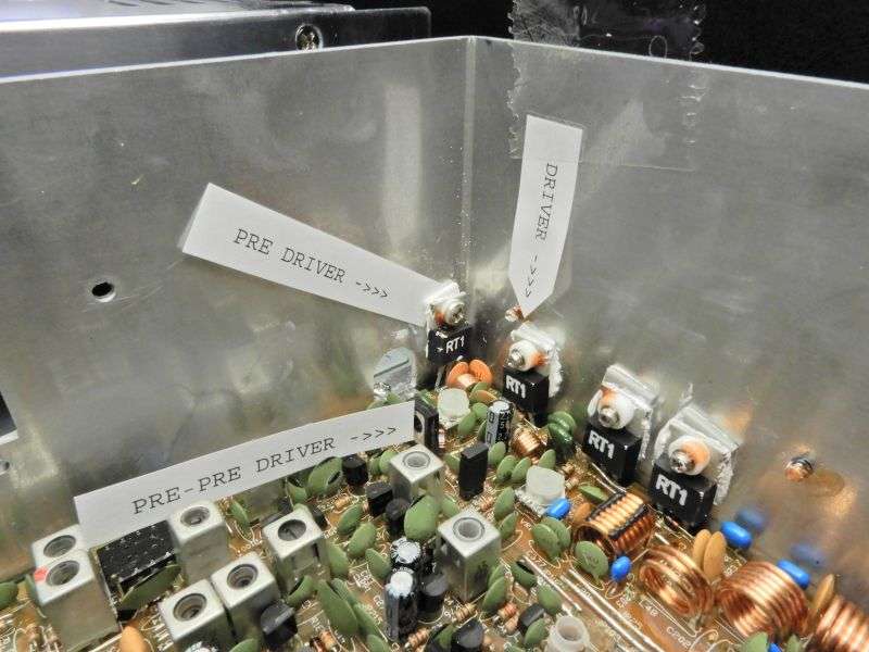

I did get this one. Leads me to the subject of my discontent. This radio sounds like poo on sideband transmit.
Here's why, best I can tell. Too much gain packed too tightly together.
The nasty sound of sideband transmit comes from RF feedback between the final stage and the low-power stages. Until this model, RCI radios had a tiny transistor buffer, followed by a small pre-driver (no heat sink) feeding the actual driver transistor, feeding into two parallel driver transistors.
This thing has a driver transistor feeding into the driver transistor.
In effect.

For now I'm not recommending this radio for sideband until I see a convincing way to make them stable.
Yeah, that's kinda presumptive, based on experience with exactly one specimen.
And if I never see another one again, that could be a clue all by itself.
